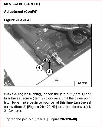

That is a really nice unit that will give you many years of service...
The adjustment procedure should fix it...
Like another poster stated just make sure to document it and report it to your dealer...

All better now. The adjustment took about an hour. I also lubed the linkage you cannot normally see while I had the seat and tunnel cover off. I video the process as well. I will edit the video a little later. Thank you all for the information.
