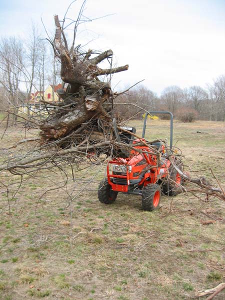

I did a lot of brush clearing on 5 acres with a CK20 HST. If I had only that original 5 acres to work I would still have the CK20. It did a brilliant job (with a grapple, bush hog and BH) and I could not have asked for more (except perhaps a suspension seat (now standard) and a middle range in the HST). The lift capacity on that little bugger was great for brush clearing. The size of the tractor was just right and the hefty weight was all necessary (including filled tires) because of the loader.
For the work you are proposing I think you need an HST as there will be lots of back and forth moment in addition to just bush hogging. If you were primarily plowing or doing ground engaging work then the CK25 would have an advantage but for general utility work such as brush clearing I'd choose an HST. The CK25 KL130 loader is only a small amount more powerful than the KL120 and not enough to make a difference IMO.
