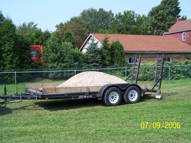

I would get the heavier trailer. I would be worried about the mesh not holding up, the side rails being in the way of hitting the doors on the Mustang, room to correctly position anything on the trailer, and just pure safety. With only four extra feet you add about 700# of weight to the trailer, some is due to the extra lenght but some has to be accounted for in heavier construction.
I use my trailer for more than just hauling the tractor. I did a paver project here at the house last year and hauled 2 pallets of pavers. The only way I was able to do this was to be able to load from the side and rear. (a deckover would have been really nice for this.) I also have used it to haul gravel, dirt, mulch, etc. by addind wood sides (see attachment).
