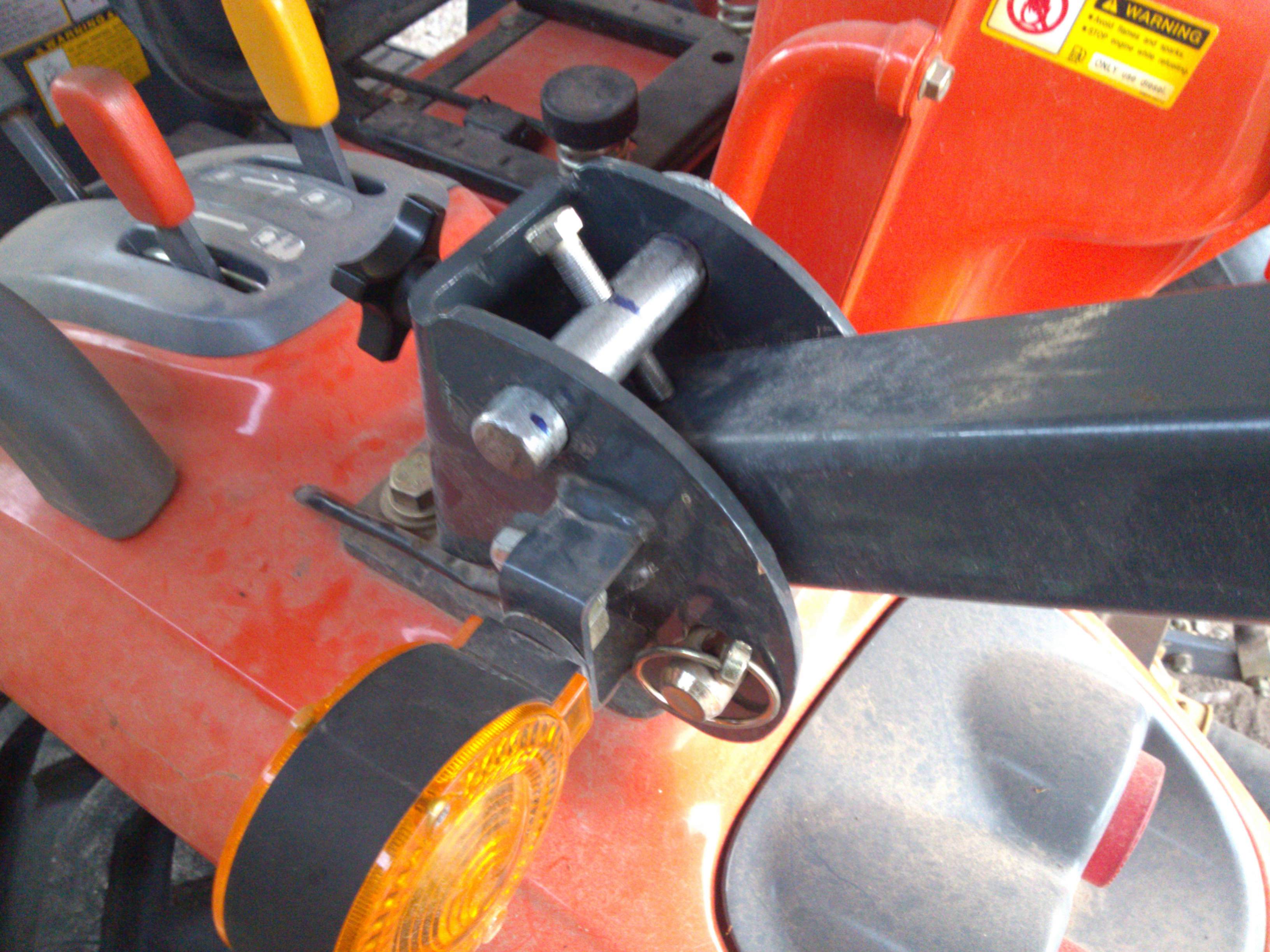

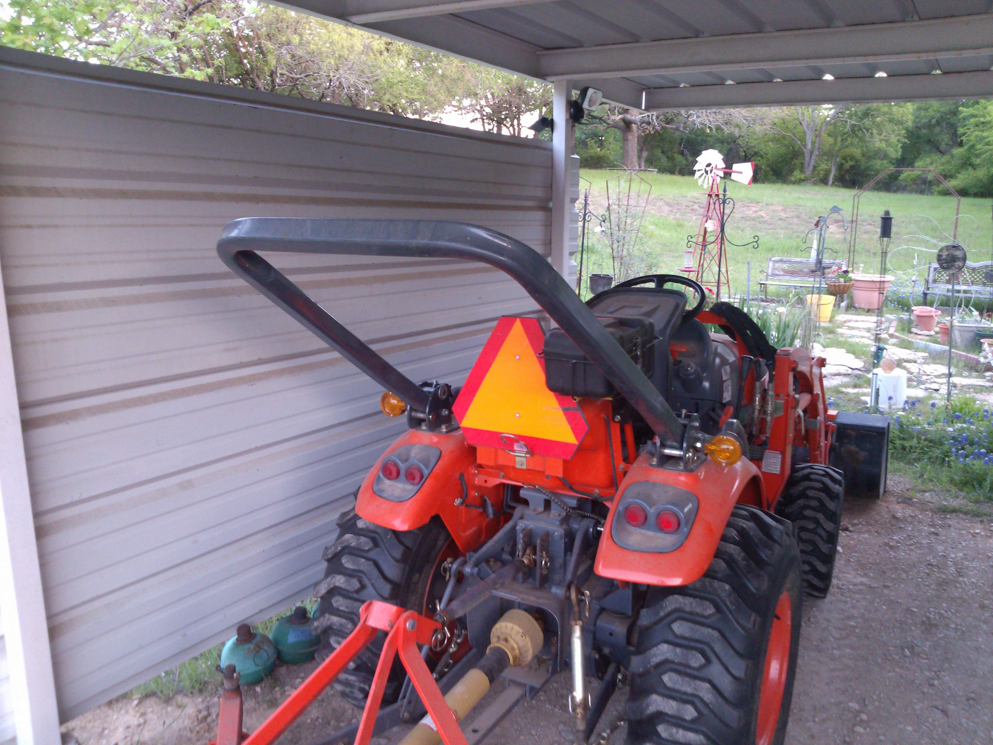

Something that annoyed me was the ROPS when not it full upright position was in a full flat position when in the down position, this would cause the mower to hit the ROPS and push it up. I tried several setting on the mower to try and stop it but nothing worked, annoyed me that I could not raise the mower all the way up for transport. So I came up with a solution, no cutting welding or marring to tractor, works and stops the mower from hitting the ROPS bar. Had some old bolts that were found while fossil hunting and they were the right size, drilled and tapped them, ta da. Solid will not bounce around in transport, mower does not hit anymore.

It is a Kioti branded 60" finish mower.
