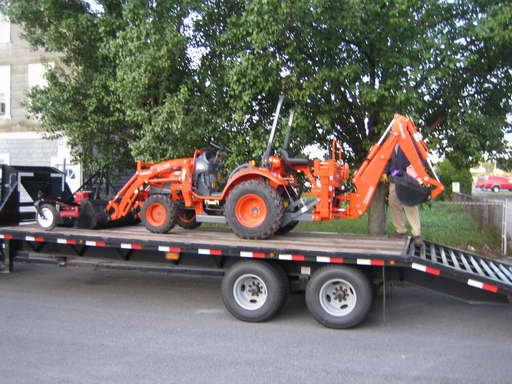

I have a CK20HST TLB. Love it. I have attached a photo of the tractor with backhoe on a trailer that sounds like yours...no problem or ground contact loading or unloading.
I use a 48" BushHog rotary cutter. I would imagine a 52 inch cutter would be about the same. Good performance in brush and no problem with 1 inch saplings at all.
The FEL on the CK20 is remarkably strong and it does have a very high lift capacity. Only 70 some pounds less than that of the CK30 FEL. I did a comparison of capacities with the Kubota B21TLB a week ago (you could search for that post) and found the two machines were almost identical. Point being it is a very versitle and capable TLB.
I have not ever driven a 3054 so cannot directly compare but the CK20 TLB has handled everything that I have thrown at it with aplomb. My only beef is that I think it needs a three range HST as the high range is pretty useless for anything but flat mowing or road travel when the machine is set up as a pretty heavy TLB.

Island, thanks for posting, and attaching the picture. That is a good looking set up. How long is that gooseneck? That unit fills her up pretty good. Do you do landscapeing for hire?

I don't own the trailer (dealers) but I recall it was 20ft. Note if you look carefully you will see a 48" BushHog hanging out of the FEL's mouth. That stuck out about 3+feet which exaggerates the total length. (By the way, the FEL had no problem lifting that cantelevered 450lb load for a 3 mile road trip).
As you note, the backhoe is only a six and a half footer. Only an issue if you are routinely digging foundations really. Heck, they had to upgrade something for the CK30, it sure wasn't the FEL lift capacity. /forums/images/graemlins/grin.gif (That'll get the 30 guys riled up).
