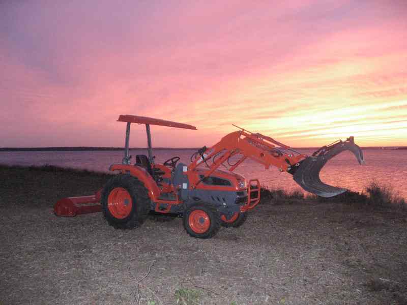

I wouldn't say the DK40se is more versatile but it is certainly lots more powerful. For my purposes, clearing brush largely, it allows me to clear about 3-4 times as much per hour mostly because the loader is strong enough to rip bushes and small trees out of the ground in one step rather than needing to "work" at them with the smaller tractor. Bigger mower and bigger backhoe also speed things up. With the exception of lifting some large rocks that I couldn't lift with the CK20 however there is no specific task I can do with the DK that I couldn't do with more time and the CK.
   / ck20 owner-just a question? #7
Thanks IslandTractor, I didn't mean to hijack the thread. I saw pictures of your new setup in another thread, and it does look more suitable for the clearing that you are involved in. I think the CK20 is a nice setup too.
   / ck20 owner-just a question? #8
I loved the CK20 TLB I had and it was all I needed for 5 acres even though a lot of that was brush that needed clearing. When the clearing project bumped up to about 20acres total it just seemed more reasonable to upgrade to a larger machine. I don't think either machine is better than the other, just different sizes and capacities.
