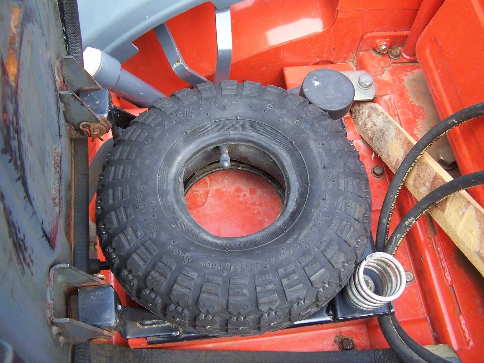

I tried a seat from tractor supply and had the same problem. You will need to find a seat that all of the mechanism for suspension is under the seat since the fuel tank gets in the way.
Somewhere on here somebody used a small tire and tube (rim removed) under the seat to offer better support that just the springs used on the seat. (It might not have been a Kioti) That is what I am using now. It has made a big difference. My wife who usually uses it to mow, while I am doing manual labor, claimed to not notice a difference until this year. The one time that I mowed I thought that the ride was rather rough. I checked the air pressure in the tire and it felt low, added some air and wow what a difference. The next time my wife mowed I asked her of the ride felt different and she said yes. I told her that I added air to that tire. She was surprised at the difference.

I might try that. I do currently have a chunk of stiff foam under the seat which does make some difference but I was hoping to get something adjustable. Air pressure would be a good way to do that. Does the tire you use fit entirely under the seat or does it loop over the two rear springs? Did you use the tire and tube or just tube? Thanks

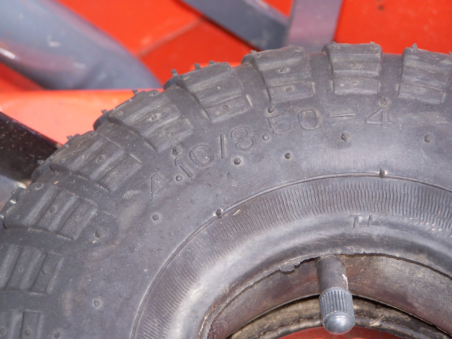

Here are some pictures. Took a close-up of the tire size. Inflate to where it feels good.
Kurt

Perfect. I had ordered a 410/350x4 inner tube earlier today. Glad to see that is the right size. I'll probably wrap it in a canvas as I don't have a tire or may take a trip to the junkyard to find a tire if that doesn't work.
