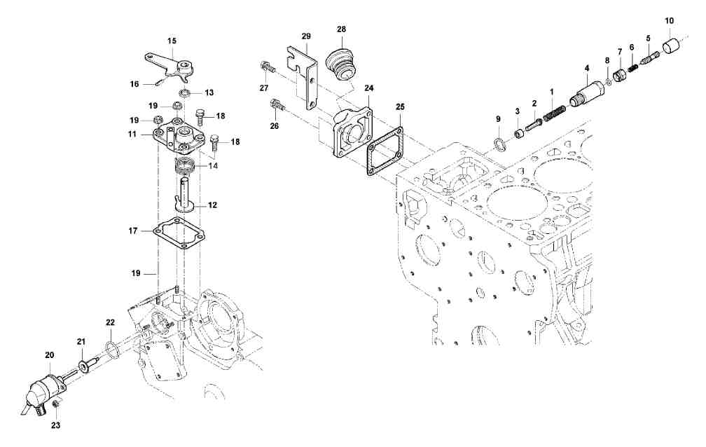

Hi fellow kioti users,
I have a new (45 hrs) ck20s which has developed a small oil leak. The leak appears to be motor oil (not hyd fluid) and appears to come from the small cylindrical part directly in front of the injectors, and to the right of the fan. This part is not painted. From here the oil drops down on to the right loader arm mounting bracket. I have snugged the 2 bolts holding it onto the motor, but it still seeps.
Here are my questions:
Anyone else experience this? What is this part (I don't have the shop manual) and why does it leak oil? Is it a pressure sending/sensor unit? and finally, any suggestions for fixing it?
Thanks!
   / Ck20 Oil Leak #2
This is your fuel shut off solenoid there is a o ring in there that more than likely did not seat.
This is not a common problem but it is easy to fix.
You can see in the break down what I am talking about.
#20 and # 21 is what I am referring to.

Thank you Rick for your diagnosis and exploded diagram! I will take the solenoid off and try to re-seat the o-ring. I only wish I were closer to PA so that I could patronize Wallace Tractor and Equipment. Thanks again.
