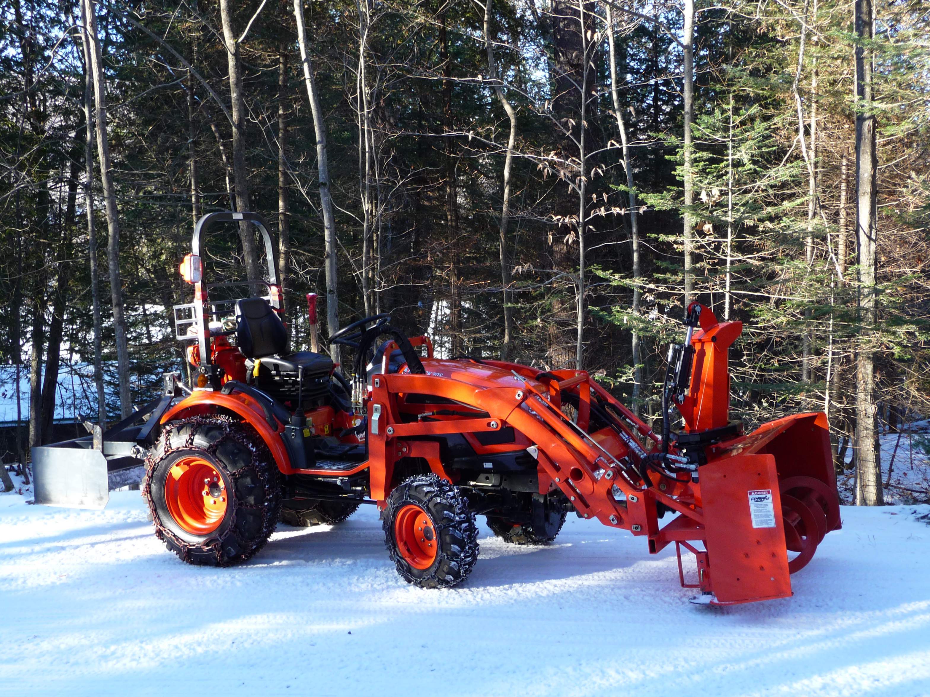

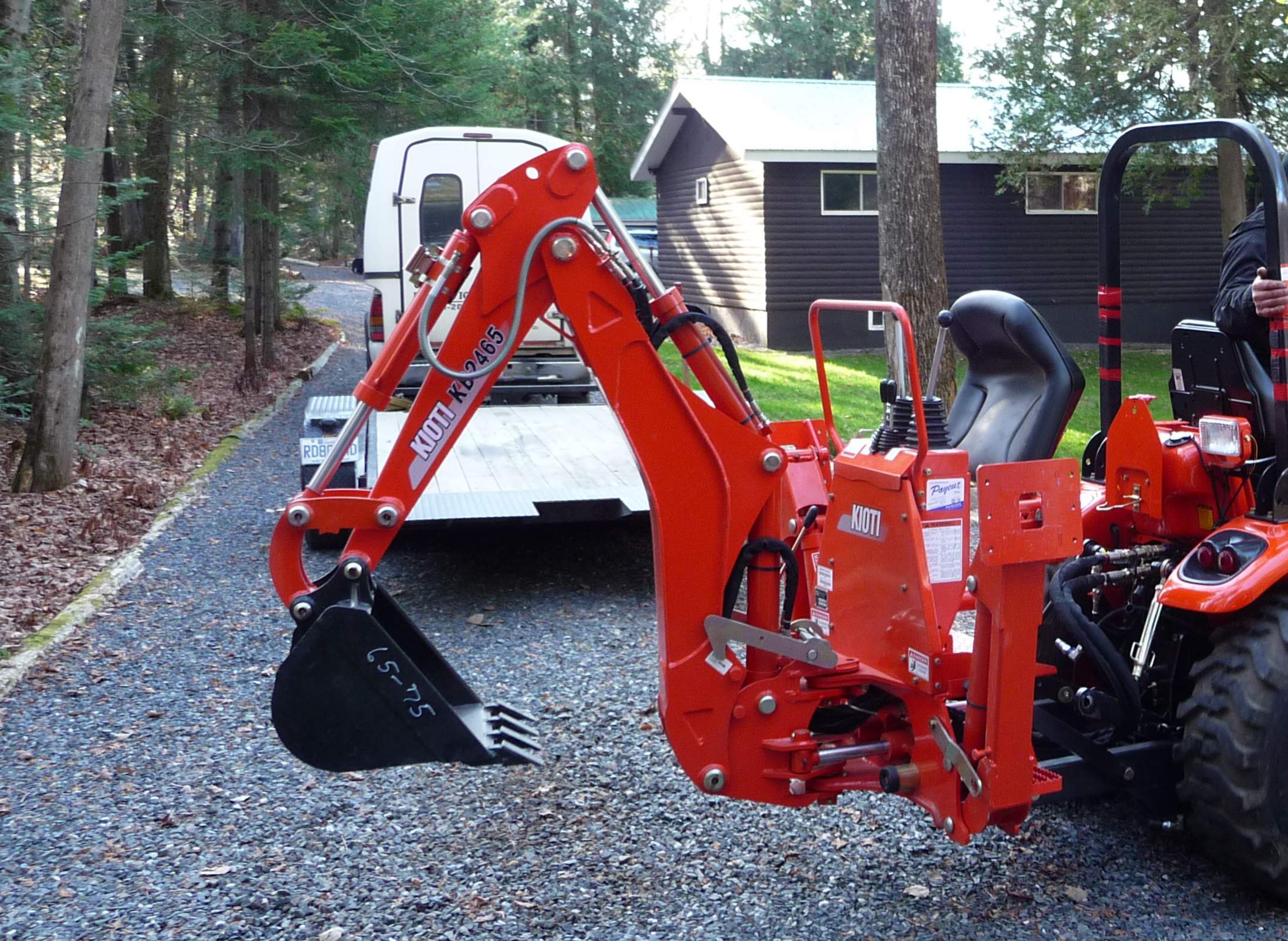

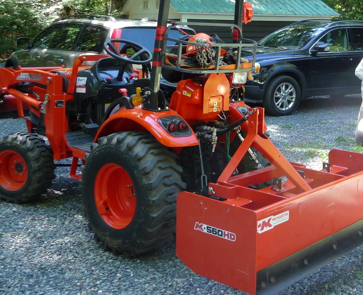

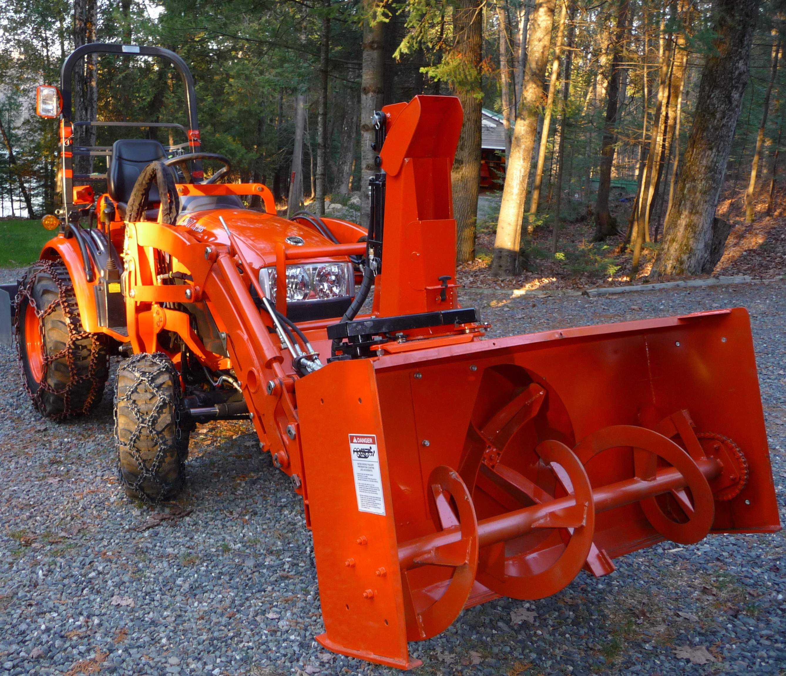

I got my CK20 HST 2 years ago. 10 acres lot, mostly for snow removal (1/2 miles snow blowing) and wood Hauling. It is a great little work horse. I'm honestly surprised by the force of that little tank! I was going to buy a CK30, but the dealer oriented me toward the CK20. Much more maneuverability inside thick forest, it will curl around pretty much any ware. It fit really nice inside my regular garage and so for I'm still impressed by it strength!
Here's a couple of pics of my CK20.
Happy shopping!!!
