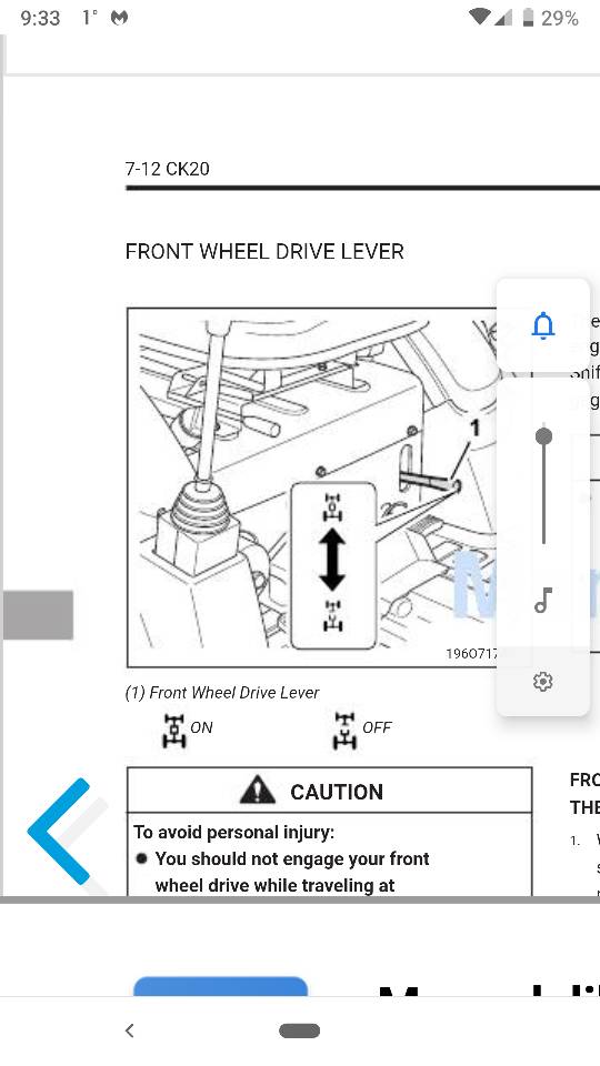

Hopefully a member with a CK20hst will respond. Do you know it's model year which may help some? That pedal you mention should be for the locking differential of the rear axle only so both rear wheels put power to the ground. My CK30hst does have a lever, just to the right of that pedal, to engage the front wheels so I can be either 2wd of 4wd. I thought the CK20s were built the same way.

I found this in an online CK20 maunual but it didn't tell me for what year of tractor so it may not apply. Hopefully someone with the same model and year will chime in. Screenshot_20181128-213358.jpeg
