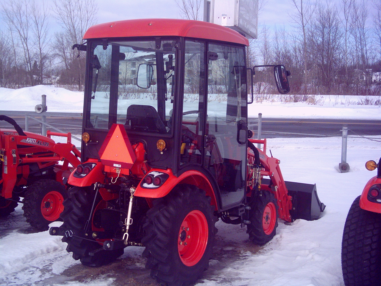

Does anyone know the height of the CK20 with a comfort cab installed? I am thinking about ordering a cab this week but I want to know if I will still be able to get in to my shop.
With the $1000.00 price rebate the cab is almost affordable ,at least if I assemble/install myself. I won't be able to get to a dealer this week to measure one and I have to order before Friday to take advantage of free freight ( my dealer is putting together a full truckload order)
Thanks Craig

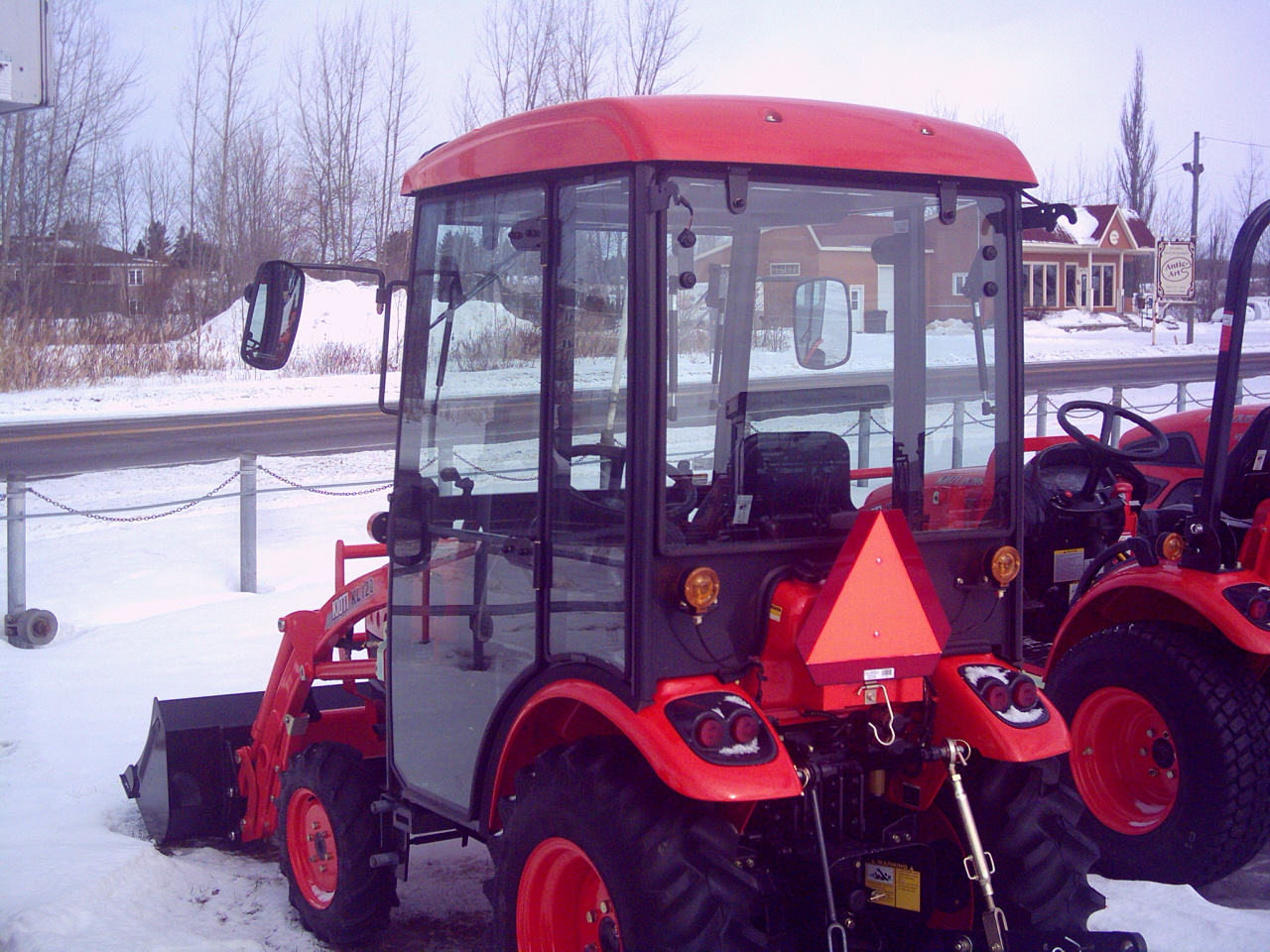

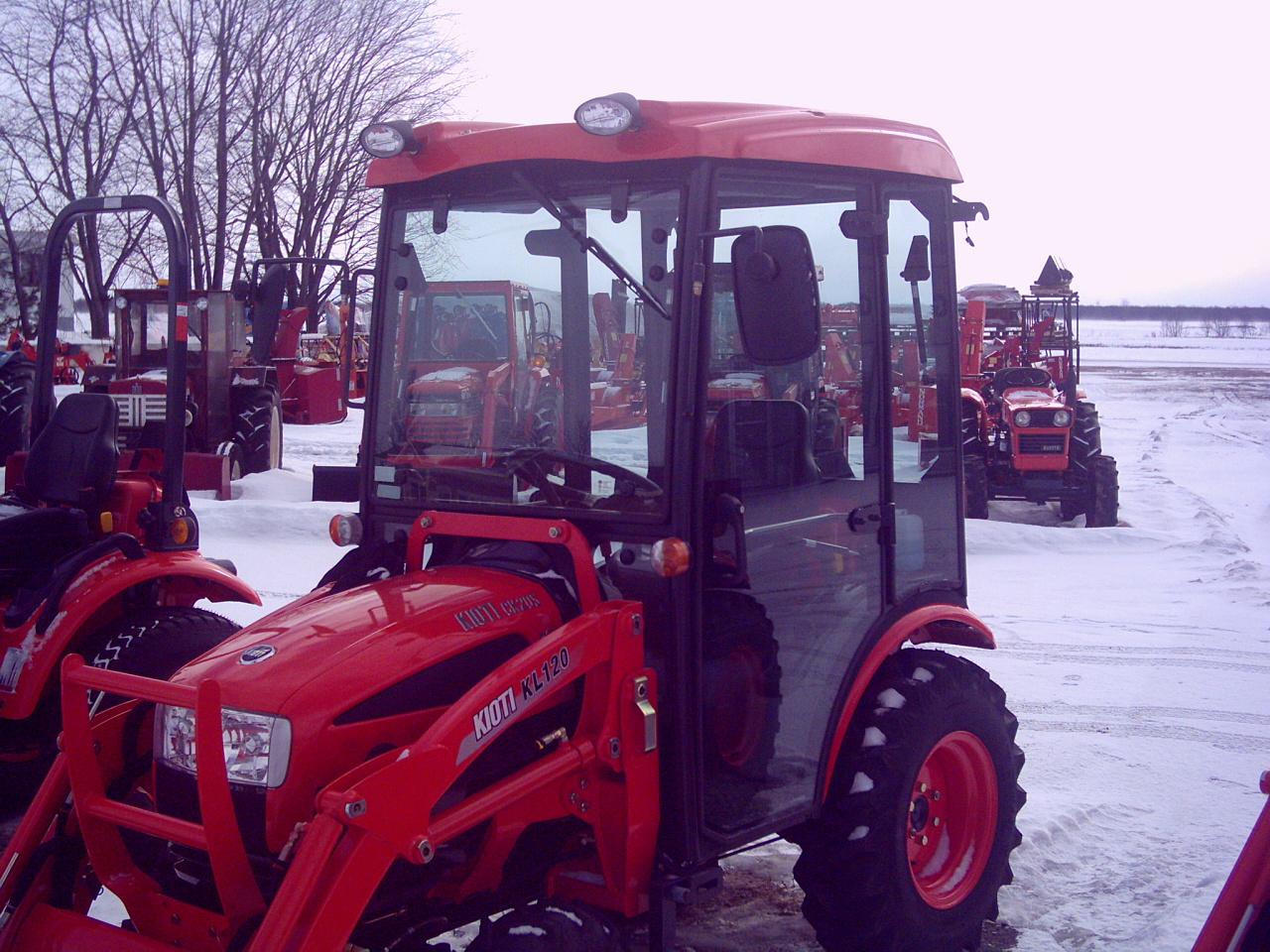

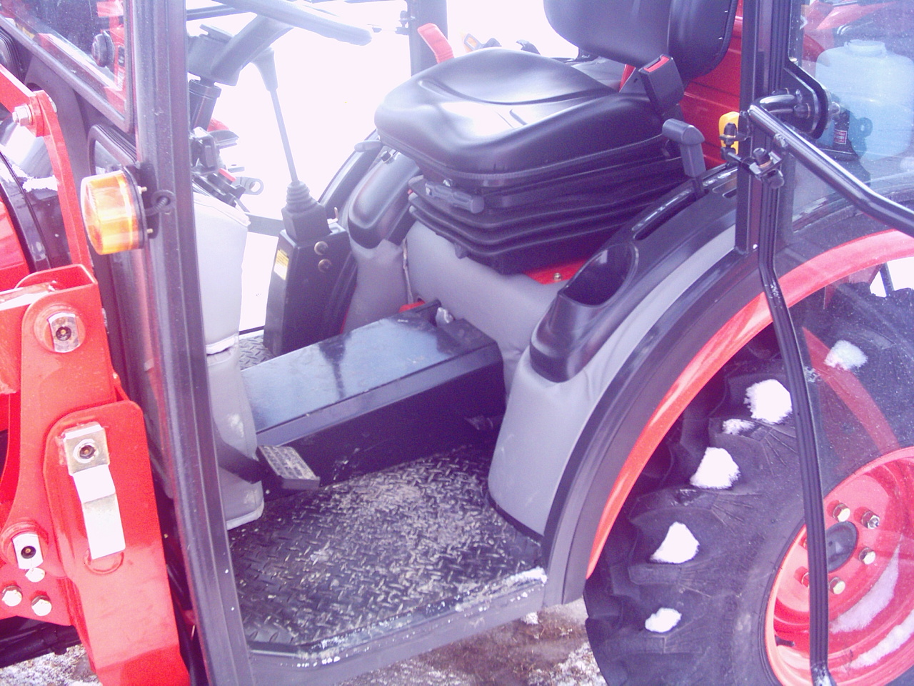

It is factory/ aftermarket ,it is beautifully finished has front lights wiper / washer heater . It also is pre wired for stereo and speakers. Two opening doors and front and rear opening windows.they even come with soundproofing fabric to complete the interior.
The price will likely depend on your location but Kioti is offering $1000 off until dec 31. If I buy one I am going to install myself, the dealerships are quoting $1000 to $1500 to install.
I would except that these would fit on Bobcat tractors assuming that the loader mounts are the same, I know the loaders themselves are different but the mounts are likely similar.the only other downside I could see for these on a bobcat is you would have an orange roof........Craig

The Kioti cab is 86" +/- installed on the CK20. The SMV sign has a bracket that connects to the lifting bracket which will increase the height to about 92". If you find a different mount for your SMV you should be the same height as the ROPS going by the brochure specs.
They are time consuming to install, but not difficult. The hardest part is installing all the upholstered padding inside the cab.
If you have a KL120 loader you want to get the new hose kit which relocates the hoses if you have an older CK. Also let them know if you have a HST or Gear the interior package is a little different.
Good luck, they are a great cab. We just delivered one this week.
