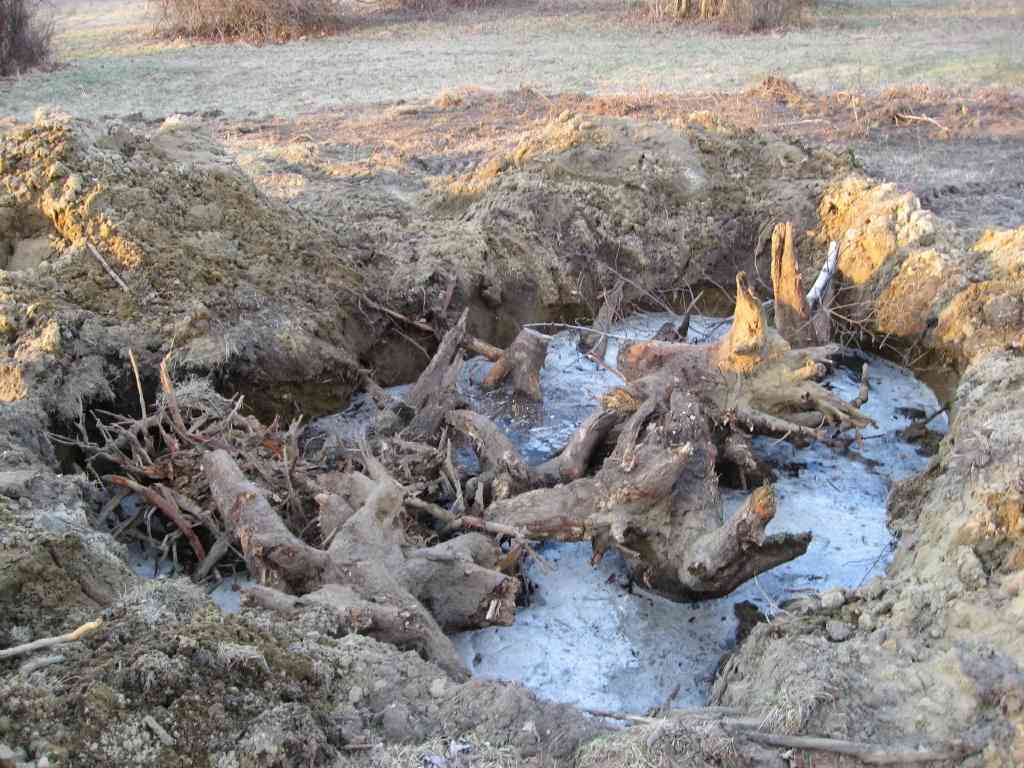

The issue here is how deep the KB2365 will dig. I believe most backhoes are rated at a depth that they can dig a flat bottom for 2 feet or so. That means that to get maximum depth you would need to move the tractor every two feet. I am not certain about that standard and Kioti does not explain what they mean by rating the KB2365 at 76.5 inches but I think my explanation is basically correct.
I have this backhoe but I've never had to dig a defined depth and I am usually digging only 4-5 feet down but reaching much further as I remove stumps. I've attached a photo to show what the backhoe can do. The hole and all the stumps in it were dug up in one long afternoon. Soil is sandy so that made it a bit easier. After needing to dig a big hole to get a twin stump out I decided to bury that stump and the others in the hole. I took the photo a few days later and water filled the hole up but it was about 5 ft deep and probably 10x10 feet across. Enough room to bury half a dozen decent sized stumps.
