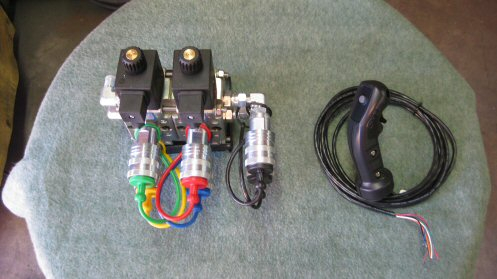

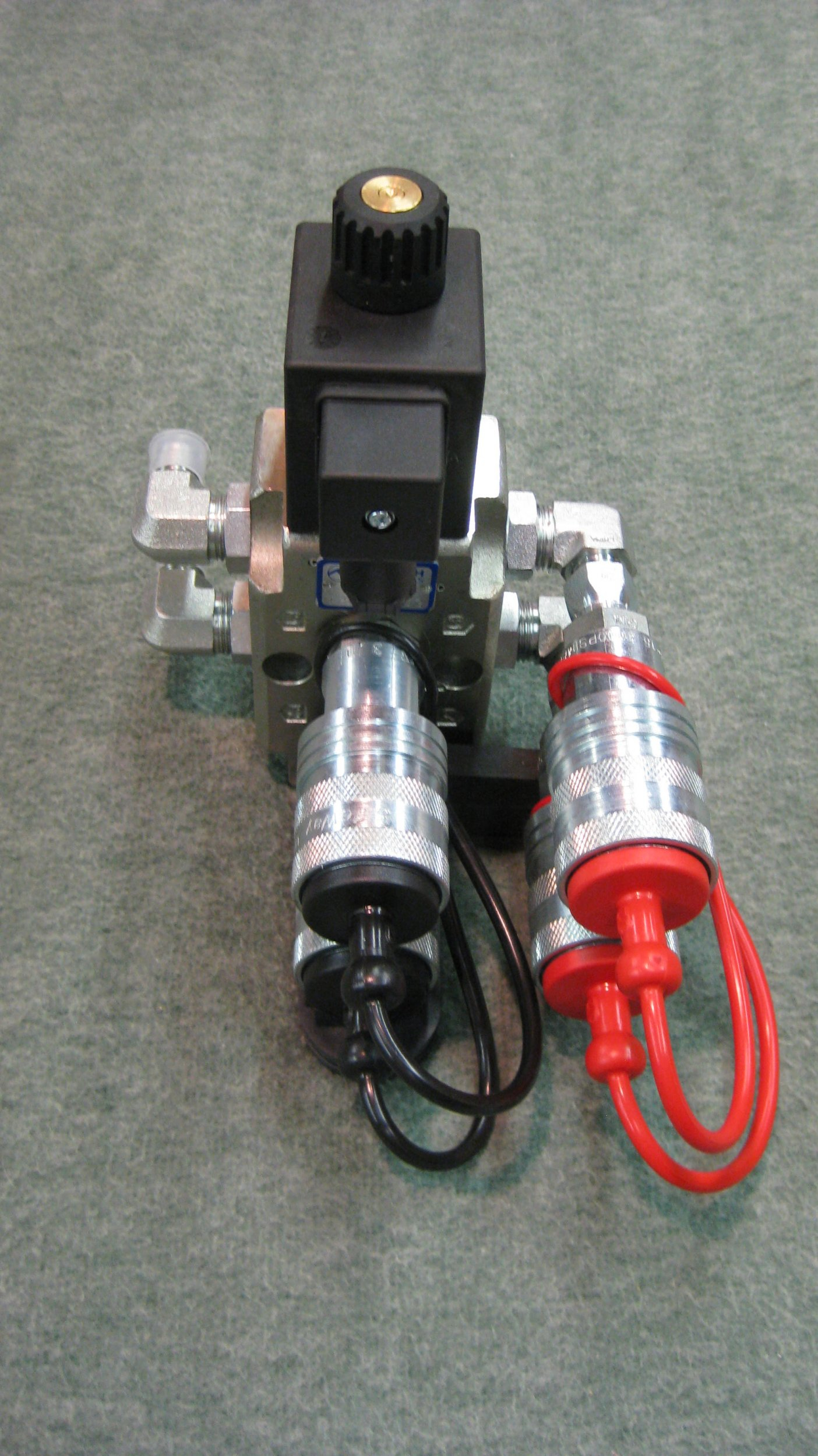

hey everyone. New to the forum here.
I'm getting ready to buy a compact tractor, and leaning strongly towards a kioti ck4010se. The kioti really seems to offer the best bang for the buck. Since one of its main functions would be drive way maintenance, I'll plan to add a top and tilt with a decent box blade. While i don't have any immediate plans for any rear implements with additional hydraulic functions, I can imagine perhaps wanting a third function back there for blade angle or rippers or something. Is there an OEM or reasonably clean aftermarket setup to add an extra hydraulic port and control?
No OEM 3rd rear remote that I know of until the NX series. So an electric diverter or even a double diverter on the back would probably work out the best.
Hi Brian,
Is it possible to get those solenoid diverter valves with 3 positions? A center to maintain flow to the end remotes, a top position to divert flow to the additional remote, a bottom position to connect the ports of the additional remote and create a float (and likely still end up blocking the end of line remote ports, but I could live with that). You would need a spool with a solenoid on top and bottom and an electric switch that has a top, center, and bottom position. Certainly such spooling arrangements exist, just not sure if they are packaged in a manner that would fit into the tractor nicely.
I'm going to be good with my 2 factory remotes that would be the same as the Ops on the potential CK, but will need more when I pick up an offset flail and will want float for the tilt of the flail so it follows the banks. Getting the float incorporated with the diverter valve would be a very tidy way of ticking the box on all requirements.
   / Ck10 3rd rear remote? #5
What you are asking for does not exist in a mass produced valve that I am aware of. You can always get something custom made, but BIG money. There is a way to add an additional electric valve and have a full travel float position.
You understand that there can be issues with the closed float position that you have described.
If you will need float for your flail mower, simply add the diverter to the lift function of the loader valve and use a maintained switch.
