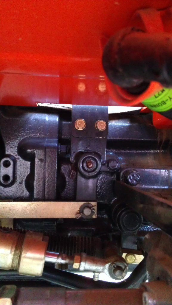

There are 2 grease fittings in this photo. One on the center pivot of the hydro pedal, and one on the bottom of the silver linkage. Both had never been greased on my tractor. When I greased them the pedal moved so much easier, that I was shocked. Also, both of the bolts holding the pedal on were loose. I bet most of the pedals have never been greased.

No problem. I seem to find a new one every time I look at the tractor. I found one on the three point hitch control lever by accident also. I think making a checklist is a great idea.

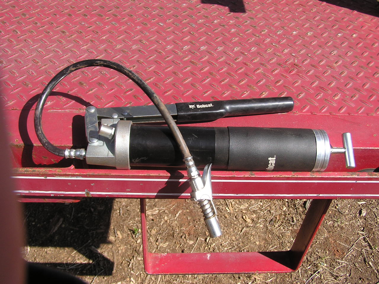

I wish I could use the Lock n Lube. It is too big to fit on the recessed zerks on my loader.
