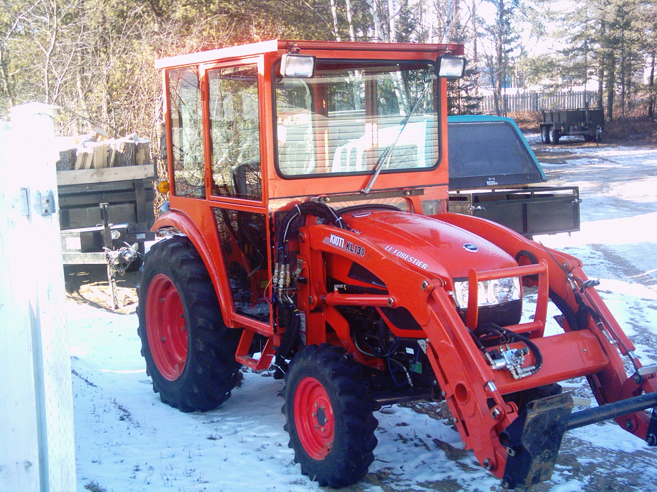

I have just finished building my own cab for my tractor, everything is completed, but one thing remains to be done. The heater has been installed, but i don't know where to plug the heater hoses, also should i remouve the thermostate and change to something hotter:confused: Any help is welcomed.
The tractor is a 2010 CK30 Gear.

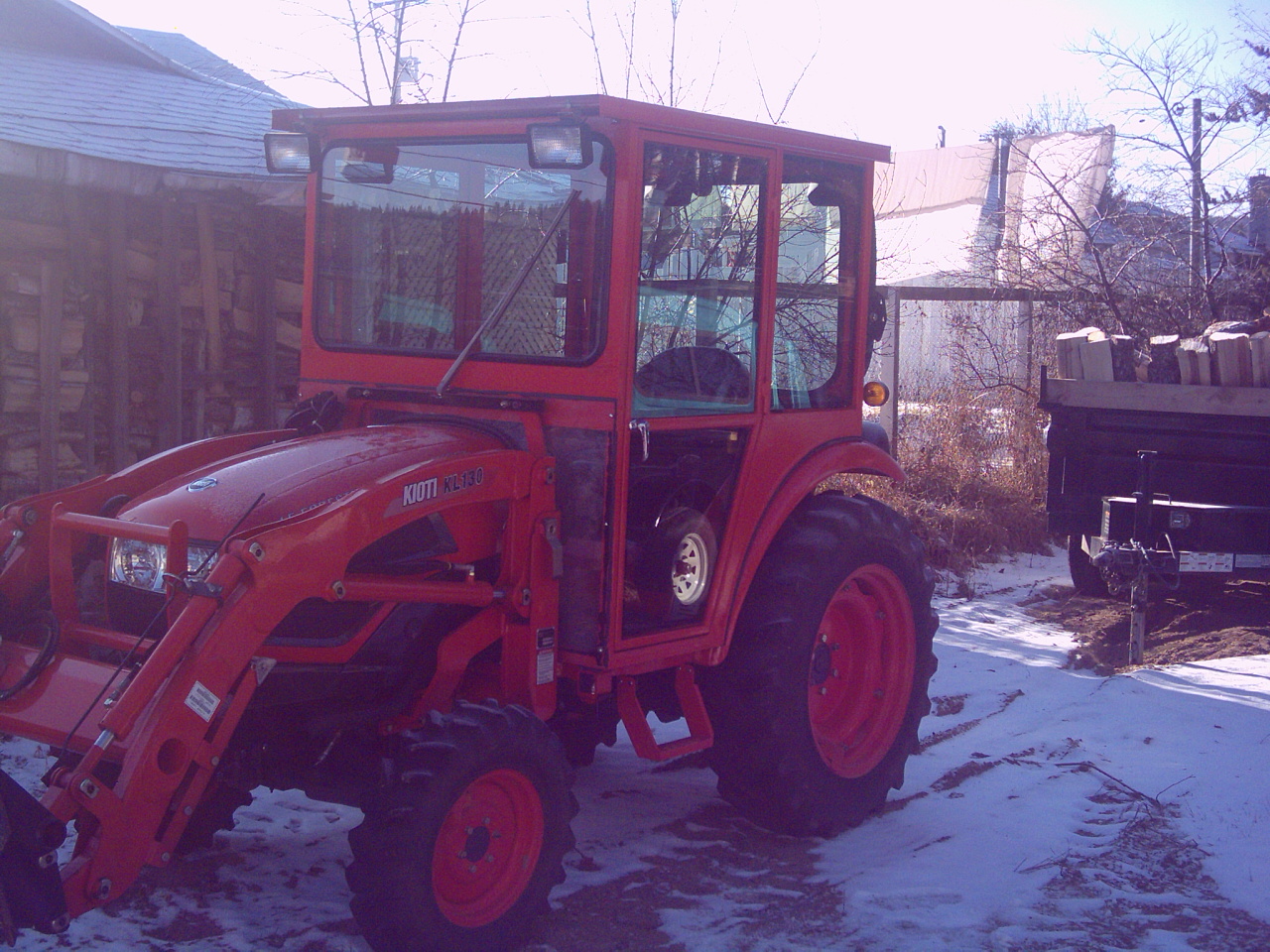

Thanks for the reply, i'll have the parts needed to plumb the heater this week, meanwhile the cab is complete and functional. Ohh and these are the pics of the finished kiotikarl cab:D I got the complete build in pics if anyone is interessed:cool:

Looks like it came out great. Looks even better than the store bought cab on mine.
