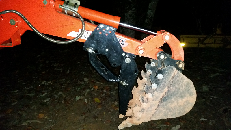

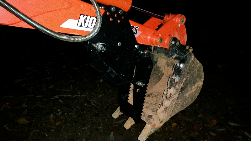

I contacted BXpanded about thumbs. He said he's thinking about one for the Kioti and would have to get measurements. I offered to take measurements; no reply. I also asked if he had the dimensions of the one he makes so I could figure out if it'd work. Also no response. I was considering designing my own but I'd have to have a steel company cut the steel since I don't have the metal working/welding abilities. The MIE unit is too expensive for me to justify so far.
I tried for over a year to get Harry to build me a thumb. I finally figured out a way to do it cheaper. Buy the Titan bolt on thumb from Amazon or another retailer and saw the mount in half. I only had to purchase 1 $5 pin to make it all work. I have a CK35 with the 2475 hoe. The thumb cost me $200!
Harry builds a good product, and I will be getting a tooth bar from him. I just felt like he had other more important projects.

Worthb, that's what I'm looking for.
Could you explain what you mean by cut. And also is there enough clearance between the dipper arm and curl cylinder?

The side plates that mount to the boom are welded together with a plate at the rear, and a boss for the large bolt that the thumb pivots on. I simply made 1 single cut in the middle of both with a Sawzall to separate the mount into 2 halves. There is plenty of clearance for the curl cylinder. I eventually stacked 2 small pieces of 3/16th plate under the adjustable plate at the top of the thumb so I could slide it further down the boom. I did have to buy 1 longer pin for the rear linkage pivot at TSC. It works very well for a $200 experiment.
