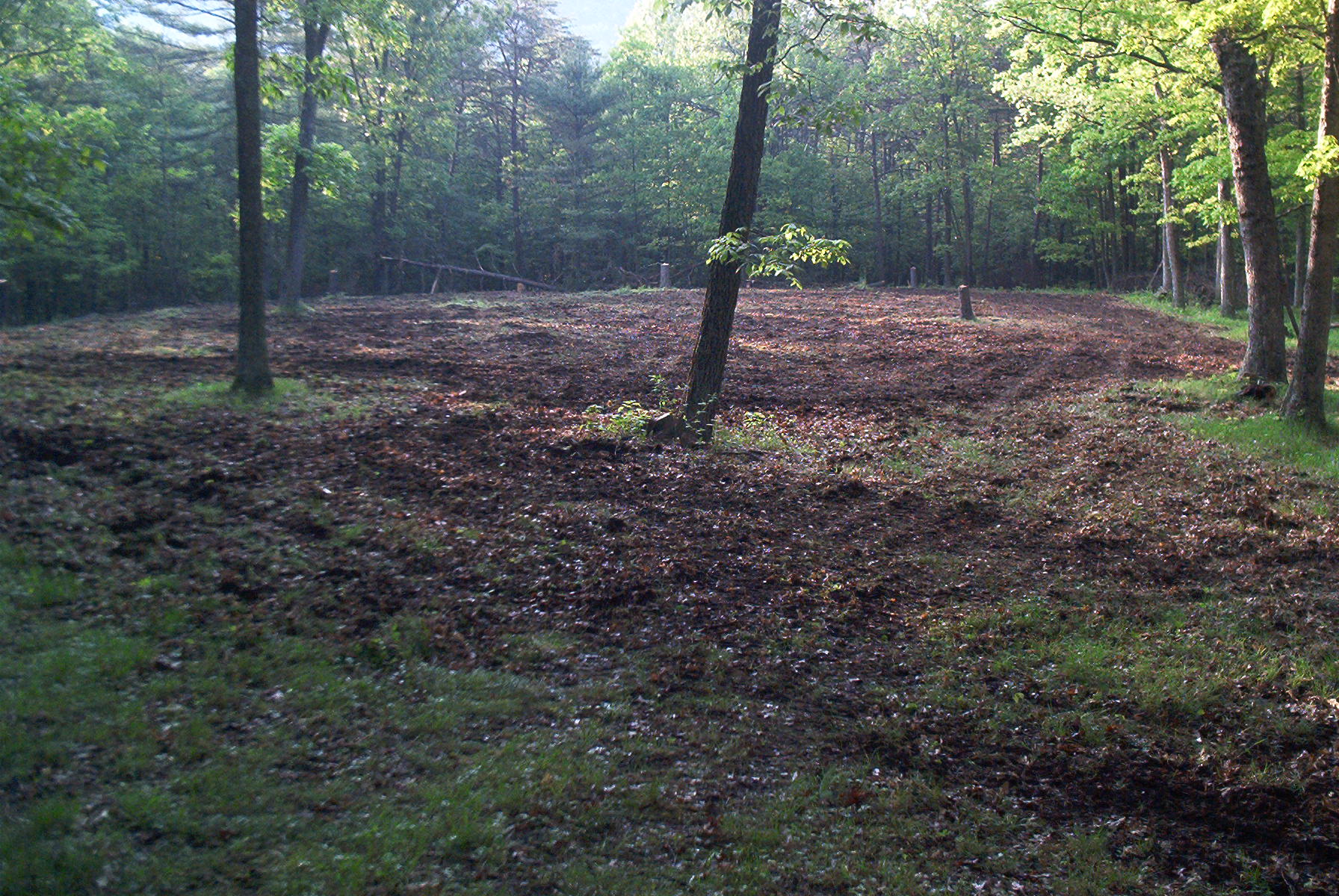

I think you will be fine. I use mine for food plots as well, I have a 5' angle iron frame (light duty KK) harrow disc. It works just fine and I have no problems at all pulling it. I would maybe recommend further research on which disc's you get on it. I was dumb and didn't care when I bought mine; it has the serrated blades, not a full round plate. Well when it comes time to use it, the disc doesn't effectively break up the soil unless I add farily good weight to the disc. As well I have to make repeated attempts criss crossing-figure 8's to do any damage to churn the soil up. It does eventually work. Mine is used primarily in southern central PA deep in the woods with plenty of rock. The disc seems to go right over top of the rock
The farmer up the street from me has a much bigger tractor and a bigger disc. I was watching him pull it one day I guess rejuvenating his pasture or something. Anyway his disc had the full plate style no cut outs around the edges. This appeared to do a much more effective job slicing into the soil and turning it over as he made his passes through the pasture.
Note: You will most likely have to through it into 4wd once you start churning up the soil. Since the implement will cause resistance when it comes time to turn the wheels on the front the don't grip so well in the loose soil causeing you to slide. Also for my setup I have weighted tires on R4 with the FEL on for extra weight, I run in low range 3rd or 4th
Hope that helps. - attached is a pic of one of the food plots I used the disc on.

7mm, that food plot looks like a great place to kill a spring gobbler but the range looks a bit short to really air out an ultramag!

Shoot, I sold that Ultra Mag last fall after 4 years, I could never get used to the insane recoil it packed. I dropped back to a 25-06 rem, much more managable to shoot on a regular basis.
I just never figured out how to change my call sign with out starting a new one.
Each year my food plots seem to get better looking not sure about attracting the wildlife though. It is hard to compete against the farms in my area this year since it seems like everyone has planted corn, hundred of acres of it.
