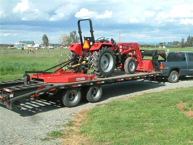

On my 10-acre place (flat pasture) I use a 2008 Mahindra 5525 (54 hp engine, 45 hp pto, 2WD, gear tranny, power steering) with the ML250 FEL (6-ft bucket, 2950 lb lift to 10.5 ft height). Cost: about $18K. My bush hog is a 6-ft Hawkline ($1150).
I traded the 2005 Kubota B7510 HST (on the left in this photo--21 hp engine, 17 hp pto, hydrostatic tranny, 4WD, power steering) with the LA302 FEL (4-ft bucket, 800 lb lift to about 7 ft).

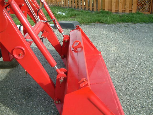

You'll want to have the dealer weld chain hooks onto your FEL bucket (my dealer welded on these hooks that I supplied). There are many variations that you can find by searching TBN.

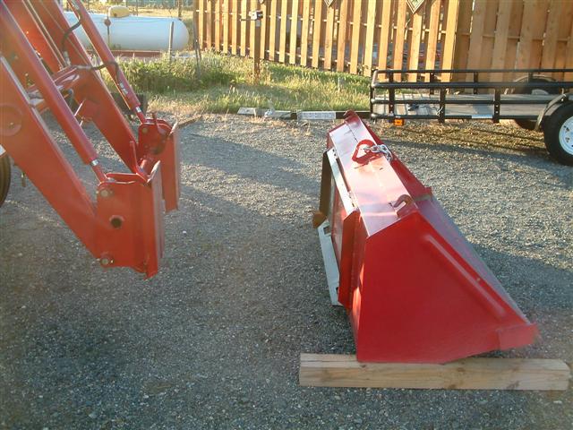

I also recommend a skid-steer-type quick attach option for your FEL. This one cost about $900.
