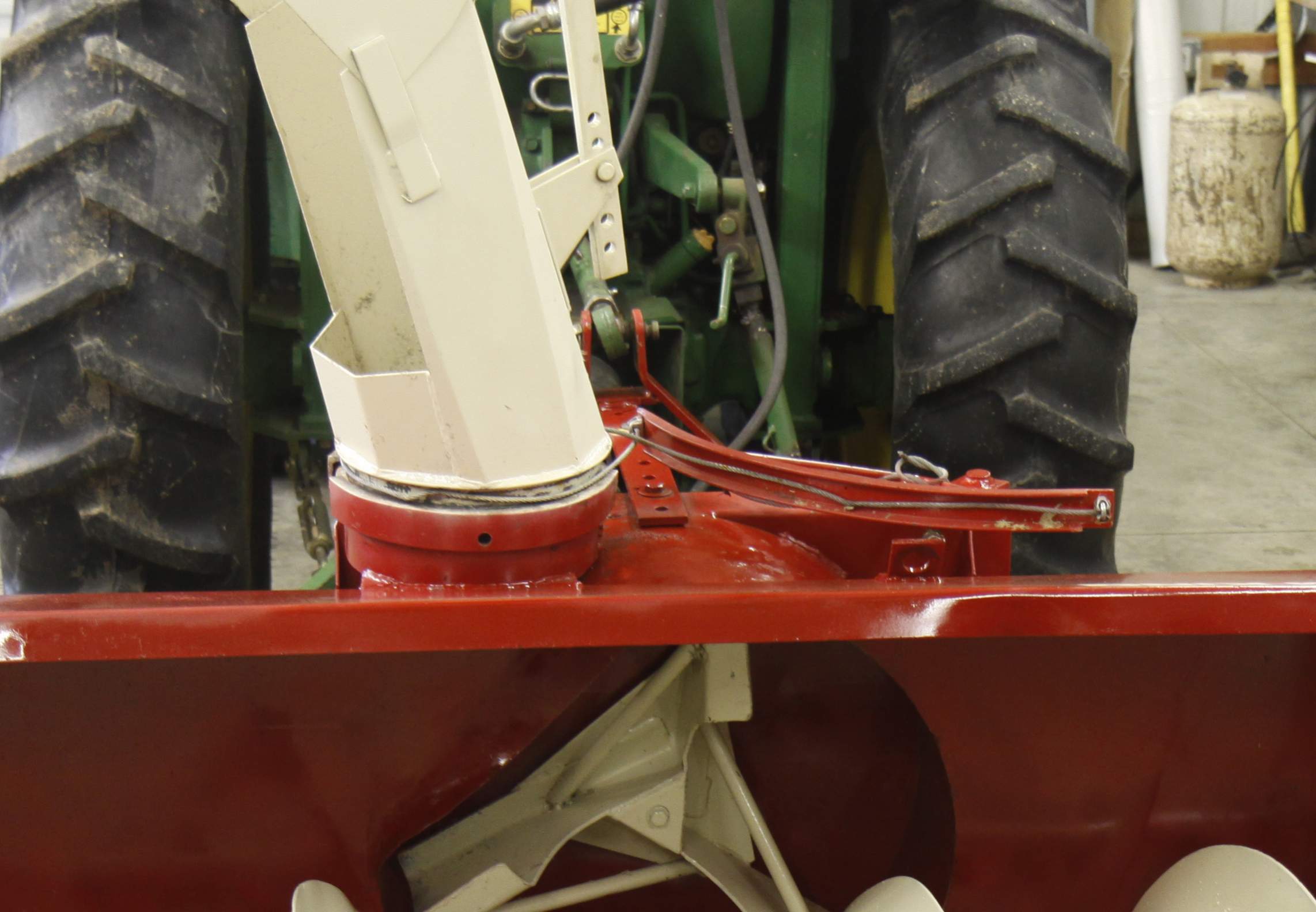

not sure about your brand, but Buhler/farm king makes a current model chute rotator that should be able to be retrofitted to any snowblower. Its simply a half round rotator and cable, plus you add a 8" double acting cylinder. thats all it takes. Im sure you can retrofit it. heres some pics of my old one.

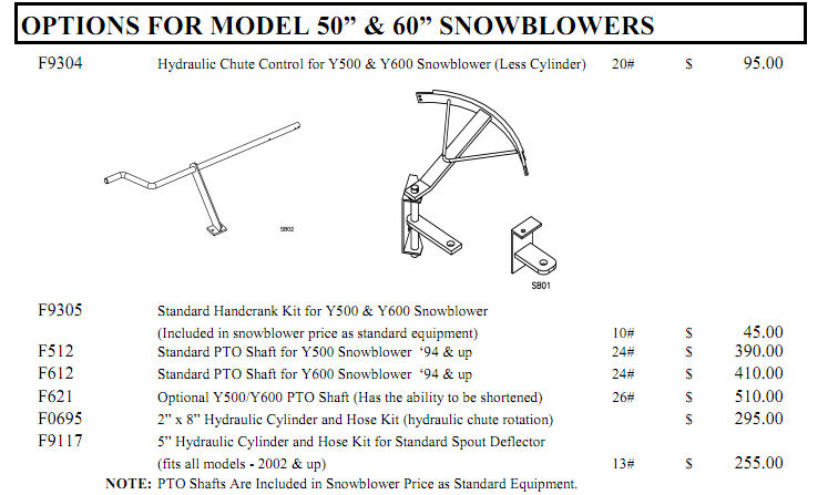

The attached figure shows the part no. for the rotator in the previous post ...this is from the Buhler catalog http://www.edneyco.com/assets/files/category/Snowblowers/Farm%20King%20Snowblowers.pdf
I am looking to buy one, myself, but haven't found a source to order from, yet.
just contact Buhler, and they will email you where you can get the part. Thats what i did about 5-6 years ago, and they got me in contact with a canadian distributor. took no time at all to install...worth every penny.
