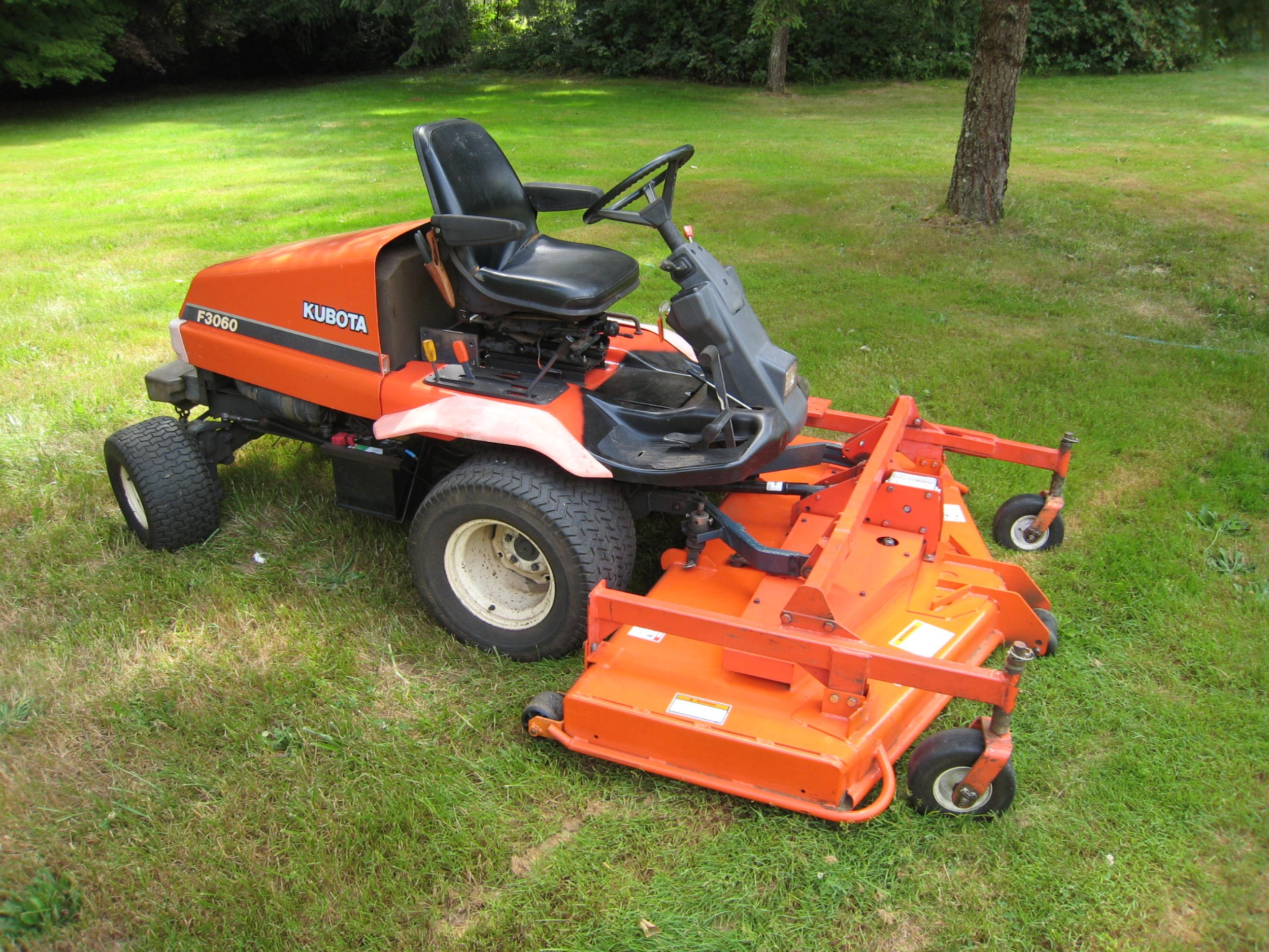

Was looking for alternatives to the steel F chute. I have already damaged 2 trees by cleaving off chunks of bark with the rigid steel chute.
My Z has a plastic, flexible chute which will not do any significant damage. Kubota dealer parts says no alternative chutes. The chute mounting points on both mowers are same. However, the mower openings are a little different. I ordered a Z chute anyway and will try to see if it’ll fit.
All out removal is not an option for me.
Anyone else have ideas to share?

When I bought my F-series used I never even put the chute on it. I had to take the chute off for it to fit on the trailer. Sometime after that I built an electric actuator Chute blocker and I would never go back with that monsterist chute that Kubota put on this.

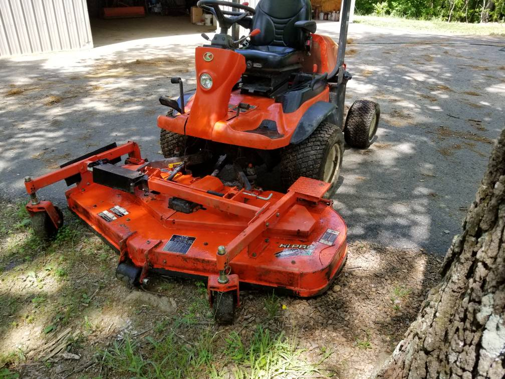

Cut a piece of a truck or trailer mud flap into same shape as metal one. It folds out of the way.

I believe you got your F a year or so after I got mine, so I wonder if they have just recently made the change to a steel chute. Mine came with a black plastic chute. Possibly the plastic chute for the 72 inch model I have would fit, but I have no idea of the part number for the chute. I’ll look at the manual to see if it has it listed.
