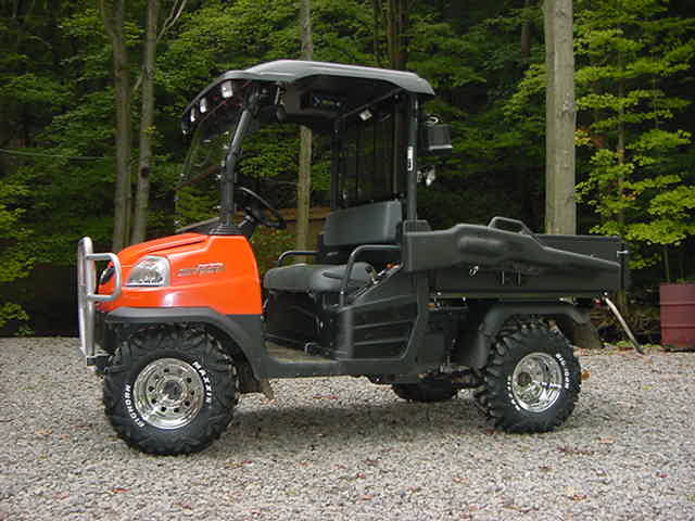

   / Chuckwagon Honda ? #8
L714
Here's a pic. A couple more things have been added. What would be visible in the pic is the winch.
Brian
EDIT - Oops. Pic. now attached.
   / Chuckwagon Honda ? #9
<font color="blue"> ( Here's a pic. ) </font>
Hold it up higher, I can't see it from here. /forums/images/graemlins/grin.gif
