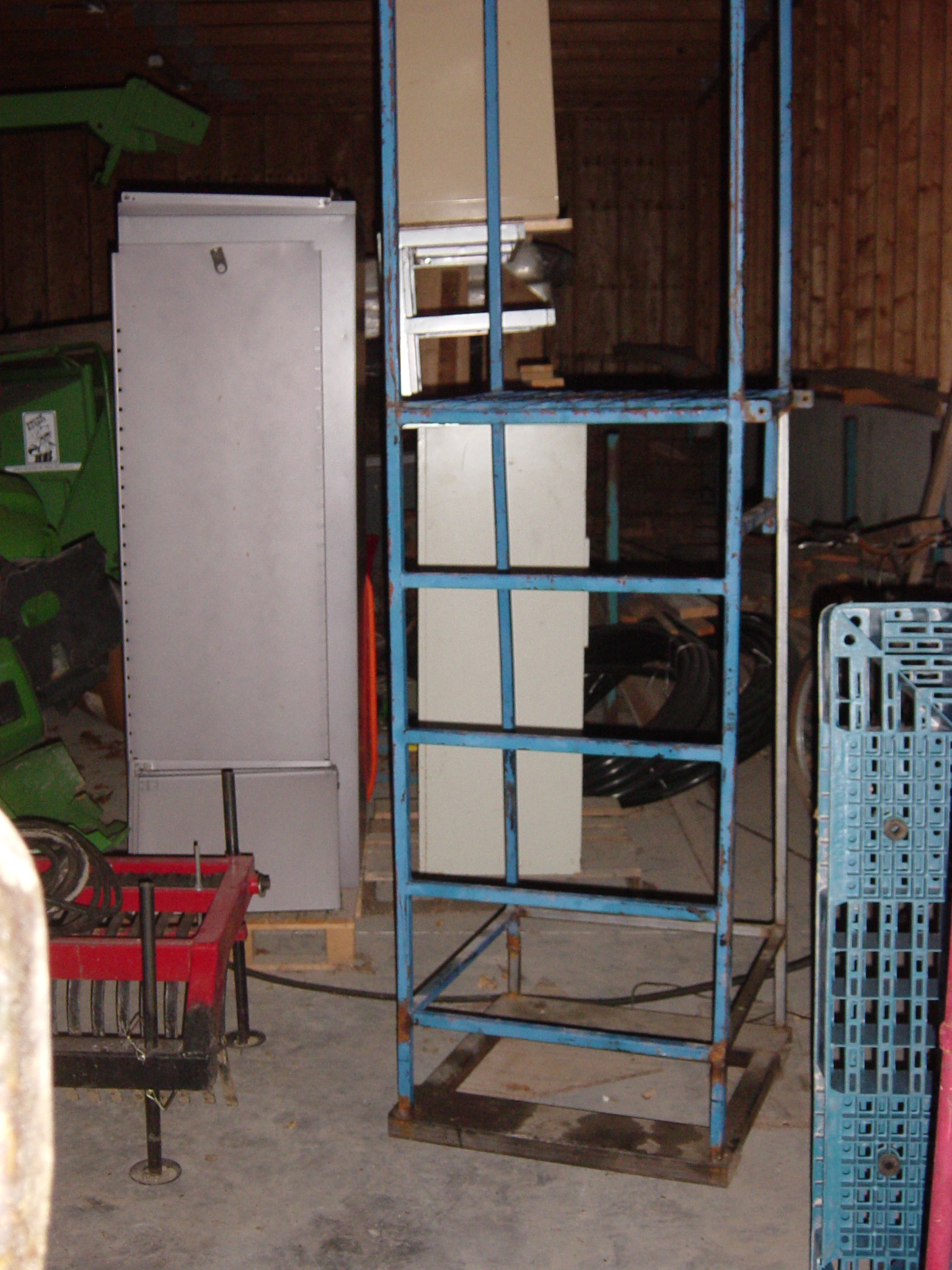

I have this contraption that I pulled out of the scrap at a friends. It had been on the back of a snowmobile groomer for trimming branches. I added fork pockets and it adds a few feet to my eleven or so foot loader height. I have little issue using a chainsaw with this thing to trim trees. On the weekend, with a long telescopic pole and my (less then qualified) female friend at the controls, we tried to string lights, but I simply lost my nerve. I am not exactly terrified of heights, but certain conditions just make me say NO!

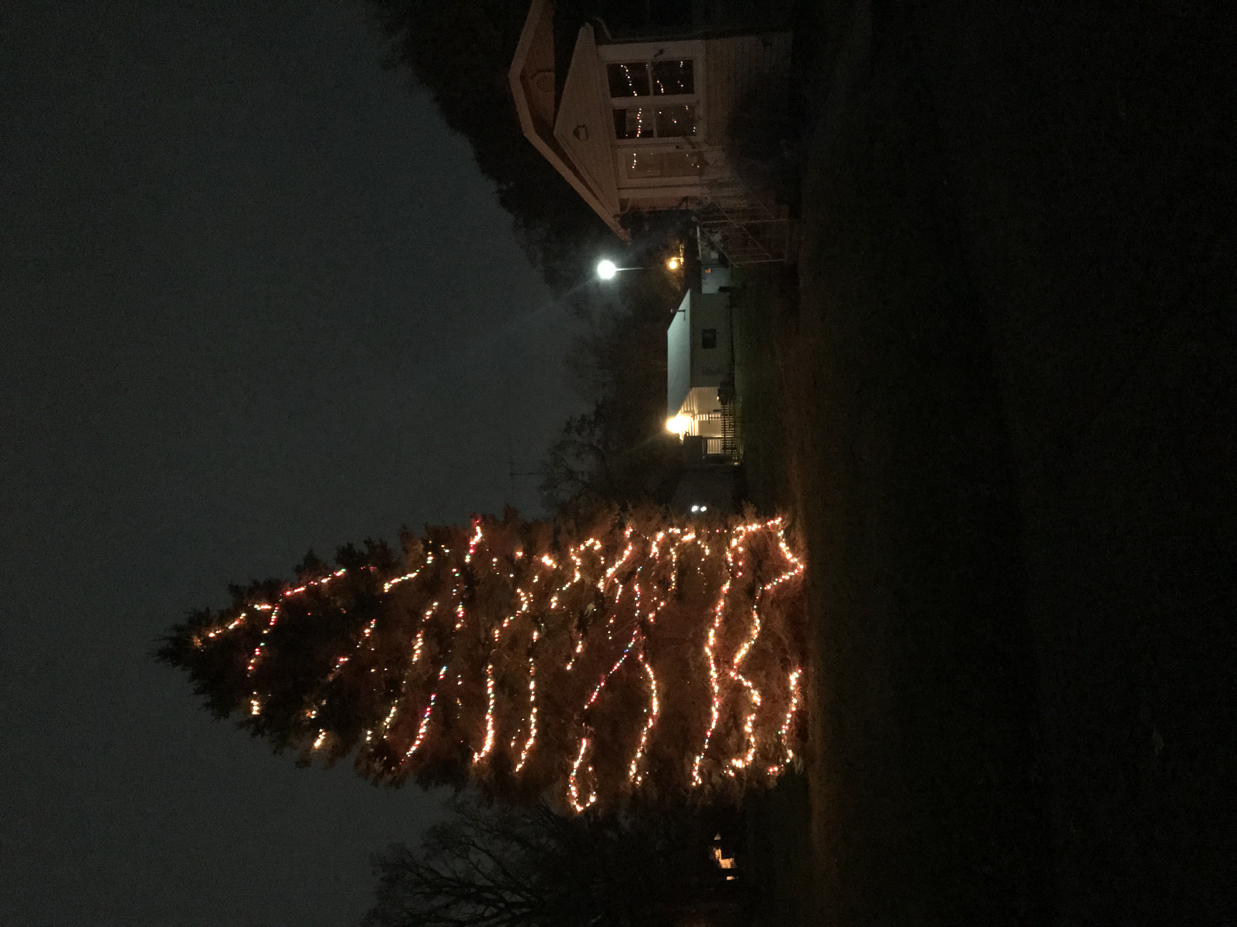

Here's my 40 footer...
No, I don't lay it on its side...
About 20 years ago I started hanging lights on it when it was a wee 25 footer. I used a 23' Mr. Longarm pole. Made a springy fork out of a coat hangar wire and taped that to the end. I put about 4' of the end of the strand in the fork, lift the strand over the top of the tree, drape the 4' section over the other side, and pull back. That released the string of lights right on top of the tree. Then, I just take the strand in my hand, and give it a backhand flip up, and that throws a loop in the strand that just walks itself up the tree. Kinda like a back-hand lasso. I continue throwing loops up the tree as I walk around it. I use 300 light strings. I connect 3 together end-to-end and tape the connections heavily for strain relief. I make my way around the tree in a spiral until I get to the ground. Then you extension cords to get the end to the back of the tree at the ground.
Next, I put another strand over the top, but about 120 degrees from the first one. I repeat the toss the loop action around and around the tree, being careful to try and space it evenly, yet farther apart, as I go down the tree.
Third, I do one more strand 120 degrees off of that, so I basically end up with three strands candy-caned down the tree.
Three strands of 900 = 2700 lights.
That all sounds easy, and I could do it from the ground. However, THE TREE GREW!!!
I tried the downspout trick a couple years, but it was a pain in the arse. Also, I do this at night with the lights lit, so I can see where I'm putting them. So metal downspouts or metal ladders or metal poles with live electric wires just says NO NO NO to me! :laughing:
For the last 7-8 years I've been using a 12' fiberglass ladder and the Mr. Longarm pole to get the first one up. That worked OK until the tree hit about 38'.
12 foot ladder, means me about 10' up. Plus my 23' pole = 33 feet. Plus my 6' body = 39' plus a 2' reach = about 41'. Take into account I'm about 8' from the edge of the tree to see where the top is, so I only have about a 38' height. So, I resorted to taping a 1-2 oz fishing weight to the end of the strand and casting it over the top.
Anyhow, as it stands, at 40' its too dangerous to stand on a 12' ladder with a 23' pole casting live light strands over the top! :laughing:
Each year I tell everyone it's the last year, but I still do it. I need a man-lift or a longer ladder. :D
There's 3600 lights on that tree now.
