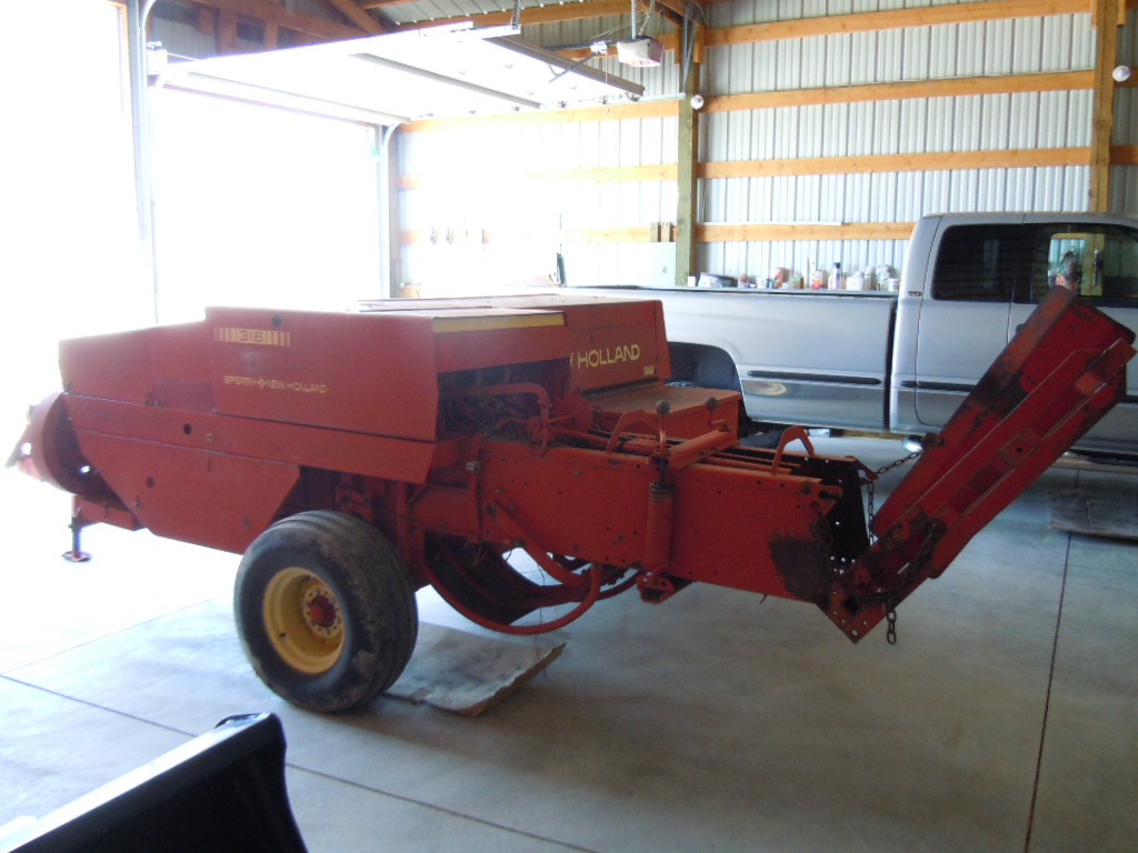

I have come across 2 interesting used balers though. One is a New Holland 316 with a thrower - does not look painted but was obviously stored indoors all of its life. Everything seems tight and clean. I have absolutely no way of knowing how much hay was put through it. From what I have read this is a reliable machine. Is anybody intimate with this model of NH? Anything I should look out for?

I'd be interested as to what the details of the "major overhaul" was. Also how many bales they think they've ran since then. The JD might be a pretty good deal. I've heard the NH 316 is a pretty good machine. No personal experience though.

A 316 is one of the two or three most well regarded NH 14x18 balers ever made. many are out there earning their keep every summer. A model 70 hydraulic drive belt style thrower is the best option available for a 316.

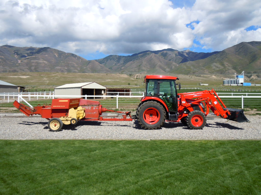

I am not anything close to an expert on balers. That said I bought a NH 316 this past summer.
I put new twine cutters on, tightened up all the chains, changed gear oil in both boxes and greased everything. It worked fine with no problems all summer. So far it was a good buy for me.:thumbsup:
