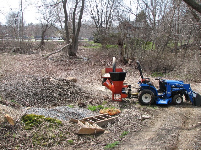

Picked up my new Bearcat 73554 Chipper Shredder on Thursday. Got to run it for 5 hours this afternoon. It has a new name - CHIPZILLA :D :D :D
Here is a mini review & some pix. I tried to convince my wife to take some video, but she wasn't inclined to help me contribute to your deliquency. Something about "sisterhood".:eek: Maybe at a future date.
Specs
5" capacity
Manual "self" feed
140# flywheel with integral blower
4 chipper knives (double sided)
~2000 RPM operating speed (has pulleys to speed up the 540 RPM)
24 shredder knives (double sided)
Weight 600#
MSRP ~$4,000
General

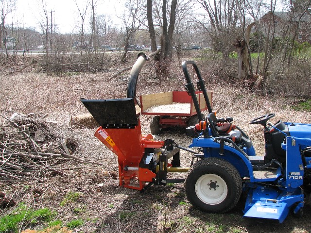

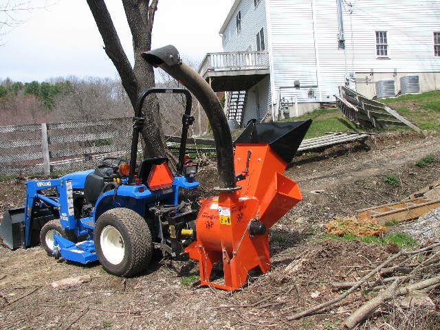

Impressive construction & craftsmanship. Nary a squeek or rattle when fired up - well balanced. This thing is solid. Although, once you start feeding it, you'll want to be wearing hearing protection (I wear my chainsaw helmet with muffs & face shield). The housing opens up with the removal of one carriage bolt. Makes for easy blade changes or to clear a clog.
The 3pt setup is not built to the quick hitch / Imatch specification. Not a huge issue as my harbor freight hitch has an adjustable hook, but a little dissapointing. Also the chute is 86" tall when the unit is on the ground - unless you have an 8' door on your "equipment shed" (I don't:mad: ) you have to remove it for storage (3 bolts). The chute rotates 360 degrees for easy placement.
In 5 hours of use, I generated ~5 yards of mulch. This was a mixture of limbs, leaves & bark/sawdust pile. This machine works faster than I do - I'm beat:eek:

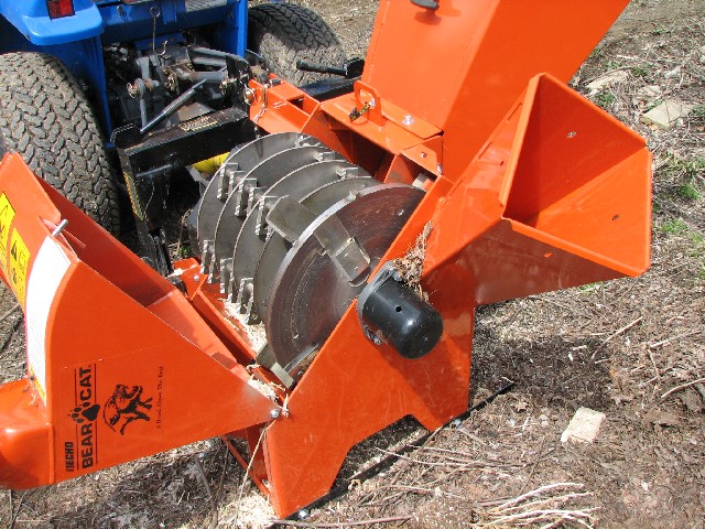

Chipper
The knives are still sharp, but the chipper pulls the wood in on it's own. Most of my wood was dry. My 18HP (14 PTO HP) tractor could only digest about 3 feet of 3" dry maple before it started to stall out, a quick pull back on the limb allowed it to recover. Generally, anything over 3" is firewood to me. The 5" capacity of this unit was great as it made it easier to feed crooked branches. The built in blower launches the chips into next week. I picked up a 6" PVC elbow to make landing the chips in my dump trailer a bit easier. Haven't installed it yet.

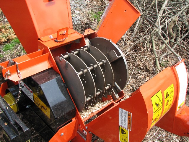

Shredder
For the smaller stuff, the shredder shines - branches up to 1" and other organic material (leaves, bark etc.) The hopper is very high, but it prevents you from getting your hand into the shredding drum. Also, the way it is designed, gravity helps to feed the shredder. On my old unit you really had to force the stuff into the shredder.
I found it worked best for the organic material to slowy "sprinkle" the material into the hopper to prevent feeding clogs. If it does plug up, poke at it with a stick. I was shredding a pile of sawdust & bark left over from cutting & splitting 8 cords of firewood last spring. It was very wet - lots of rain last week & it's been decomposing for a year. I clogged the output chute 3 times. Took about 5 minutes to clear the clog.
Dry leaves were turned to dust about as fast as you could load them in.

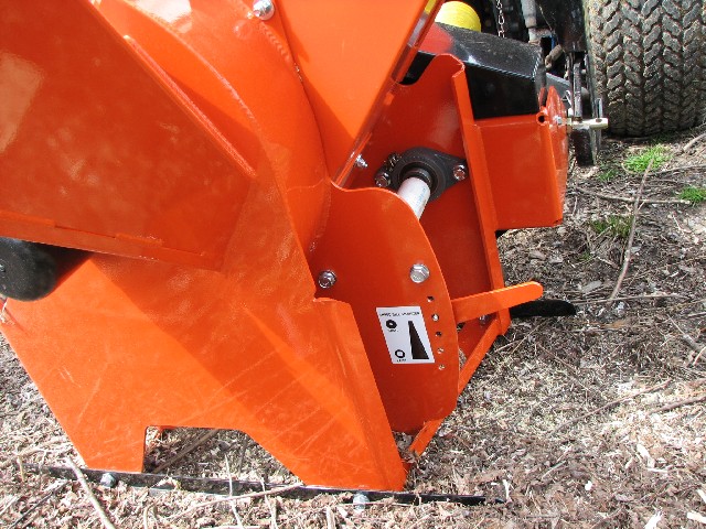

The shredder doesn't have the typical screen. There is an adjustable gap between the shredding drum and the blower. Once the shreds can fit past the gap, they get blown out the chute.
Summary
Overall I'm very happy. I'm going to write the company about the quick hitch issue as well as the height of the chute - maybe they could make it hinge somehow? Those are my only complaints.
A close second (for considerably less $$ $2,500) was the Wallenstein BX42 chipper. I decided that for my uses, I really wanted the shredder capabilities.
