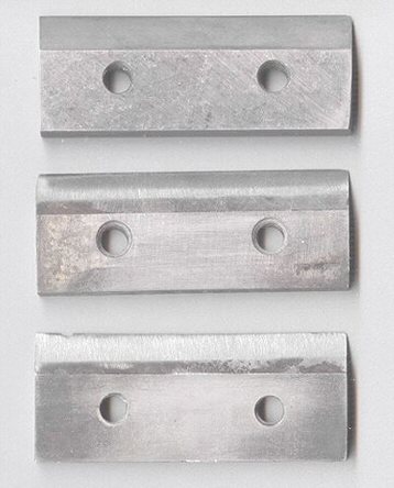

Pennwalk, maybe <A target="_blank" HREF=http://www.baileys-online.com/store/USA.htm>Bailey's</A> has chipper knives in the size you need. They have an extensive list of sizes available on line or give em a call.
Ouch! That's a shame to hear what happened with your knives.
Chipper blades, chain saw chains etc. are all to expensive to have em ruined by hack sharpening services.
Certainly my Bolens chipper/shredder isn't in the same league as the PTO units but the chipper knives still have to be sharpened too. I used to have the machine shop at work sharpen them on their surface grinder machine. (They made me 3 of the blades too.) /w3tcompact/icons/smile.gif Recently I purchased this inexpensive (less than $30.00) wet wheel grindstone #21170 from <A target="_blank" HREF=http://www.sears.com/craftsman>Sears/Craftsman</A> to sharpen my cutters and and been happy with the results. Works well to bring the edge back. In the pic the top one is still unused, the center one fully sharpened on the Craftman unit. The bottom one still needs some more work to take the nick out. Didn't want to grind off too much at once. The next time I sharpen it should be gone.
Maybe an alternative to sending them out.
DFB
