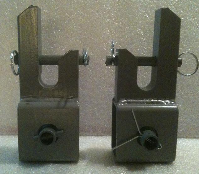

By the time I learned about quick hitches, I already had two or three implements that weren't going to work with one - I measured. After dealing with manually hooking up implements for about 3-4 years, I decided to get a set of EZ-hitches from Carter and Sons. One thing I like about them (vs Pat's, besides the lower price) is that they don't move the lift points further out. This was important since I also have a PTO chipper and didn't want to have to get a PTO extender.

Chris...I don't see how the lift point isn't moved back a couple inches with that EZ Hitch. I think I would have to buy a new pto shaft with that as the off-set seems to be about the same as the HF quick hitch. The shaft had already been cut by the previous owner, but was still too long for normal 3 pt hook- up so I cut it again for the BX.

Chris, I went to the Carter website and I see how these won't add distance between tractor and implement now. They are the bomb. I think I will have to get a pair of those. It looks like they are just up the road as well. Thanks again.

Shop around some. I forget where I got mine, but they were only maybe $80 shipped to my door. The price on the Carter & Son's sight is a lot higher than I paid a year+ ago. Search on e-bay to see what they're going for there. Hope they work out for you if you do get them.
