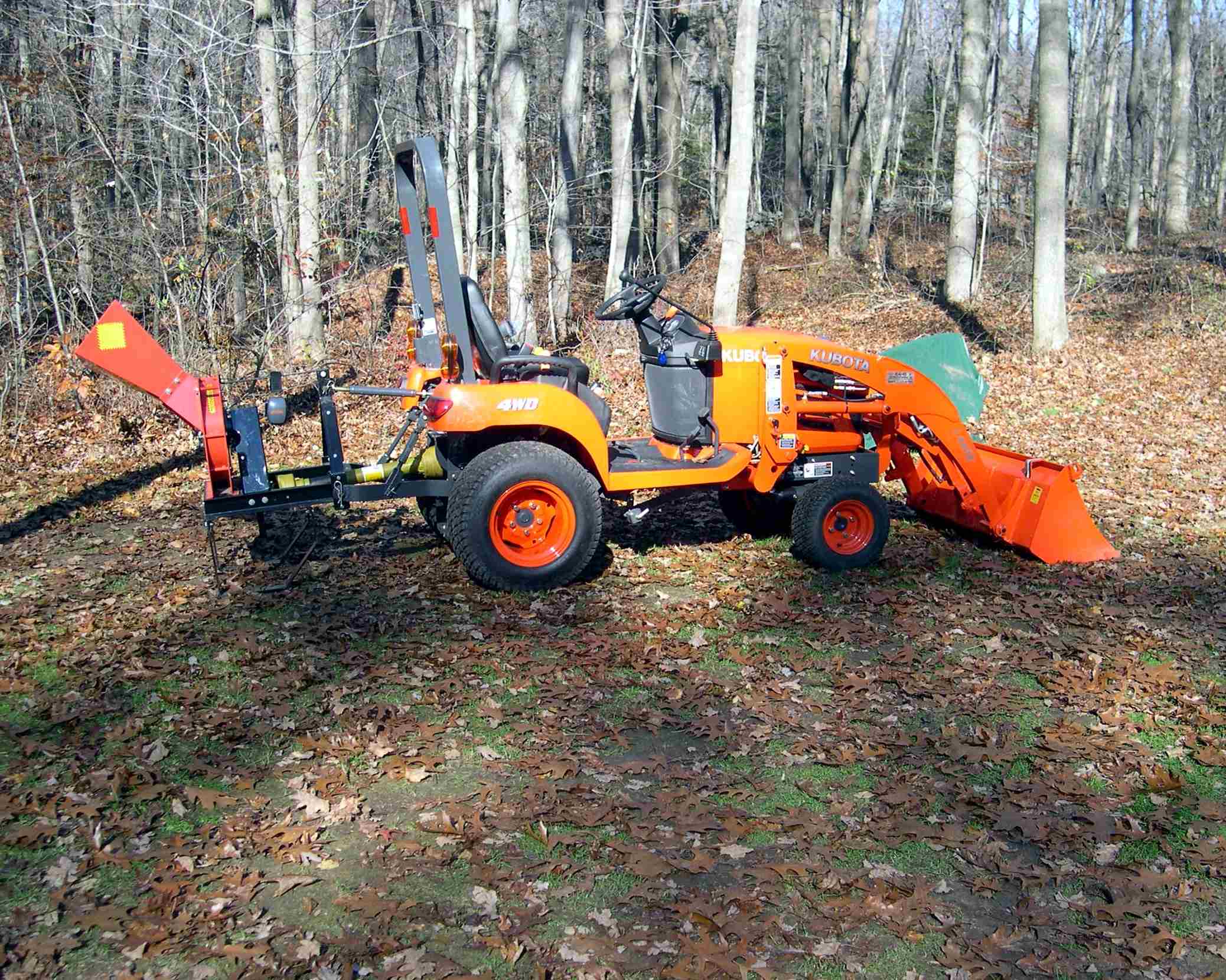

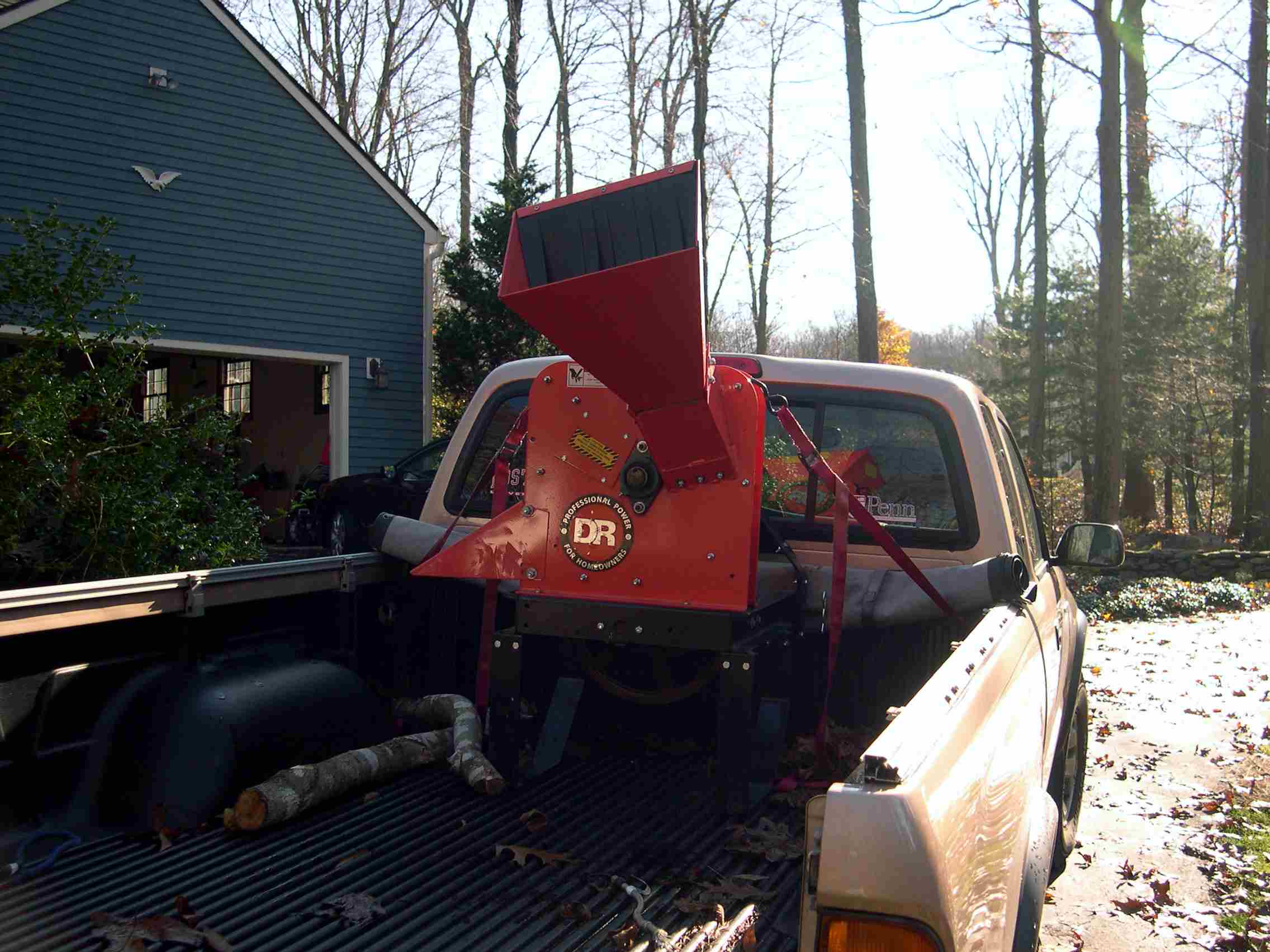

My old BX1860 with 13.7 PTO hp ran my old DR chipper just fine, and that was at less than full PTO RPM. I think the weight was between 200lb and 300lb. The chipper doesn't look that robust, but it chipped very well up to about 3.5" material (says it's rated for 4.5" max). Bought used off o CL for $1K.
