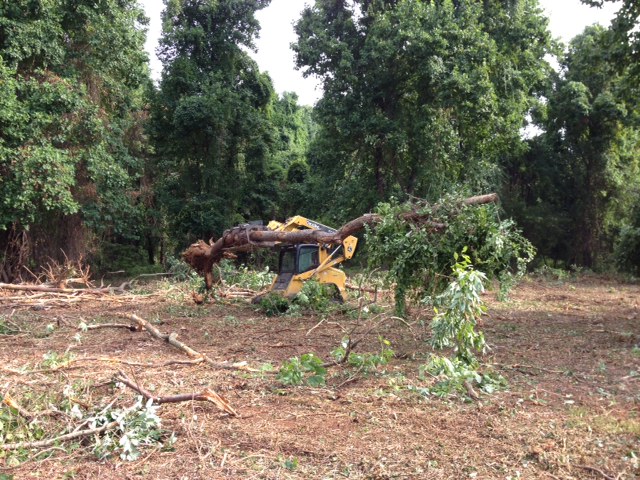

I'm wondering if something in the 12 inch range can be fed by my skid steer - see image attached which shows the type of material/my skid steer. I can easily pick up that type of size tree by the end and would love to be able to feed it directly into a chipper without getting out of the cab. CT332.JPG
Any suggestions besides the Brush Bandit and Morbark units? Has anyone used any of these? I can't find any videos of anyone using them online.

Sorry man, but you're not feeding stuff like that into any chipper. At least not for long. The butt end of the tree needs cut off. The dirt will trash the knives really quickly. That's the kind of stuff for a tub grinder or burn pile. As for other options, you could look into the Scandinavian units like this one. Hope your budget is as huge as your chipping needs.

That video is using a 210 pk or 285 metric horsepower tractor and the chipper weighs 3800 kilograms, that's 8377 pounds. It is impressive but it would take a while to feed much acreage through it. And skidsteers don't swing like the excavator. That would make loading difficult.
