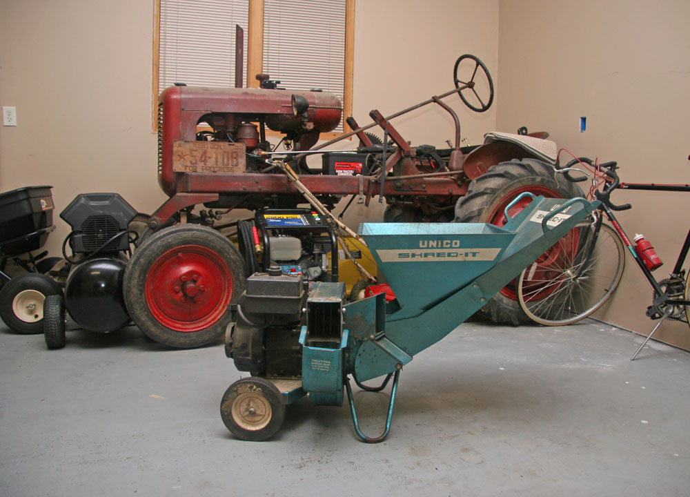

This is what I would have thought also except that I currently have an old (circa 1975) chipper shredder which has the small chipper chute feeding the hammers and the large shredder hopper feeding a single small blade, mounted on the motor shaft like lawn mower blade within the radius of the hammers, and then material is thrown through the impellers/hammers and out. The small stand alone chipper/shredders like the Mackissic (http://www.mackissic.com/consumer/leafshredderandchipper/consumershred.htm) look similar to mine except that the chipper chute is on the chute side, not the motor side.
Looking at the mackissic photo, if the knife is on the chipper/motor side, then is there also another blade (perhaps called something other than a knife) on the shredder side? Otherwise it's not clear how the shedder material is passed solely into the hammers without being feed into the impeller area within the rotating disk of the hammers due to size of typical shredder openings. Also doesn't seem like feeding even small sticks directly into the impeller area would be good on the machine.
Also confusing is that mine also has an additional panel behind the shredder hopper who's purpose I've never quite figured out except that it also a second path for material to enter the shredder (if I have my terminology correct). Perhaps I've somehow gotten terminology mixed up somewhere or I've got a real oldball unit coloring my understanding of how these things work. I'm wondering if what I originally thought was a knife on the shedder part (single spinning blade which cuts twice per revolution is really just a blade - definitely doesn't mount/look like planer type blade). Thoughts? I'll try and get a photo or two to post.
Any case, are you saying all "chippers" today are knife based?

/ Chipper Designs - Hammers vs knives?
So naturally my first usage of the chipper/shredder is for clearing out hawthornes...
Attached (hopefully) are two photos of the chipper/shredder. Note no knife on chipper and shredder with blade/hammer combo. Inherent design, coupled with limited throat capacity, coupled with challenging material (Hawthornes) probably explains it less than stellar impression so far.

/ Chipper Designs - Hammers vs knives? #6
ADin,
That's a really odd machine. My experience runs along the lines of OldFarts.
I also had a 20 year old Tomahawk that I'd sharpened the chipper blades on a number of times and replaced or turned the hammers about 3 or 4 times. Did it one more time before selling it. I always just sharpened my chipper blades on my monster grinder by placing the blades along the side of the grinder wheel. With my big grinder, this is easily done. Just have to slowly do it to keep from overheating the tempered blade.
My Mac is like the Tomahawk, almost identical, except the Mac doesn't have through-bolted blades and has A BUNCH more (and maybe harder? No wear shown yet) hammers.
Yes, about 90% of the stuff you'll do wants to go into a big chute and to the hammers. That Unico seems to be designed all wrong.

So ADin,
I think the piece of information you may be missing is that there is a slot behind the blade on the chipper input of the MacKissic so when the chip is chopped, it passes through the flywheel and gets pushed into the hammers which hack it up until it falls through the screen.
I don't know of any manufacturers that use hammers for chipping except where the material is less that 3/4" or so. You can drop larger sticks into the shreadder hopper on the Mac, but it makes one heck of a racket, and I try to avoid it.
