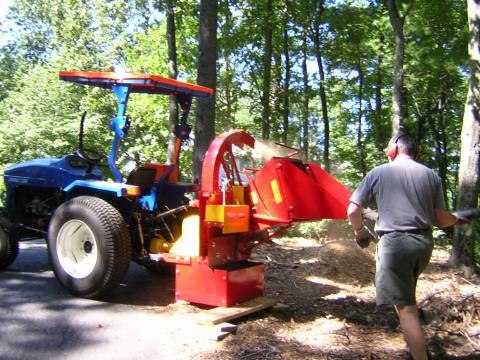

This past weekend I finally finished assembling my chipper and put it to work. Unbelievable is all I can say. This thing ate a 20' long 5" tapering to 3" dry white oak log. The motor on my tractor labored a little, but it swallowed it whole.
The chips are fairly small, about the size of chicklets and chute creates a berm like pile about 36" wide and 12' long.
Attached are a few pictures...

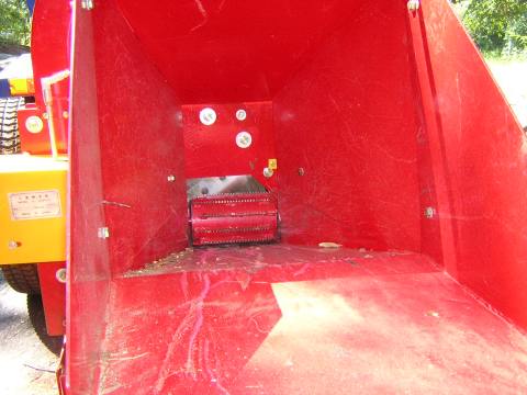

Here's a close up of the feed roller.

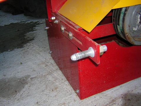

   / Chinese Chipper Review

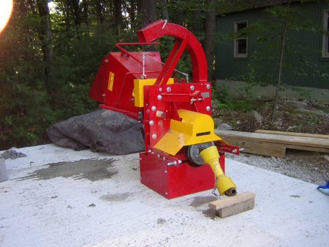

The hard part is assembling the base and lifting it in the air.

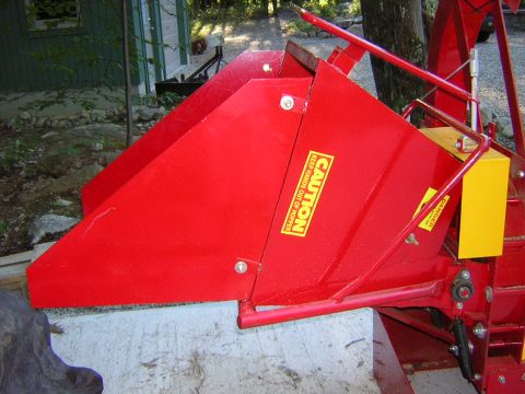

The hopper is assembled in under a minute with 4 bolts.

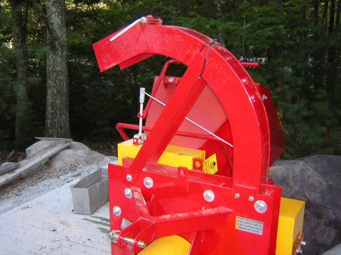

The chute takes a little while to figure out the support mechanism. I wasn't happy with the support mechanism and used some zip ties to stiffen it up.

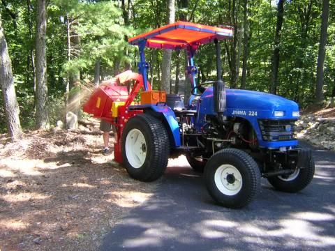

Here's a picture of it eating brush. It will swallow brush as fast as you can feed it.

And finally, here's the assembled unit on the future home of tractor implements yet to come...
