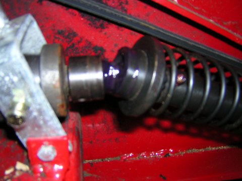

Greetings all,
I thought I publish a set of photos to help with feed roller drive issues. This is probably the weak part of the chipper if there is one.
The feed roller drive belt will smoke pretty quickly if something too big is jammed into the roller, or if it catches a limb nub just right. In 30 hours of chipping, I smoked one to death, and smoked another one pretty quickly when I didn't tighten the belt properly.
Critical to the proper operation of this assembly is the feed roller drive shaft. The drive shaft assembly consists of a male half, a female half, a ball joint on each end and a spring.
The spring in the picture keeps constant tension pushing the two halves apart. If this slip joint is not kept greased or some how binds up, the whole feed drive mechanism can be damaged.

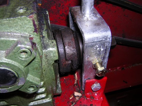

There are several joints in the drive shaft from the gearbox to the feed roller.
This picture shows the square drive at the feed roller end. The ball nub has a corresponding socket and sits on the square drive. The square socket end of the male drive shaft end sits on the ball nub at this end. It is held in place during assembly by a circlip. Looking at the assembly, there is no wear on the circlip or the ball nub. The ball nub should not come in contact with the circlip during normal operation.

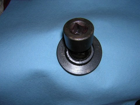

Here is the lower half of the feed roller drive shaft assembled.
You can see how the ball nub sits over the square drive from the previous photo. All of these joints are held in place by the spring. Disassembly is nothing more than grabbing the shaft and compressing the spring. The spring is quite strong and you have to be careful not to pinch a finger.

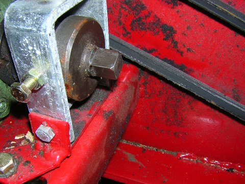

Here's the other square drive at the gearbox end of the assembly. This square drive is part of the drive release mechanism.
