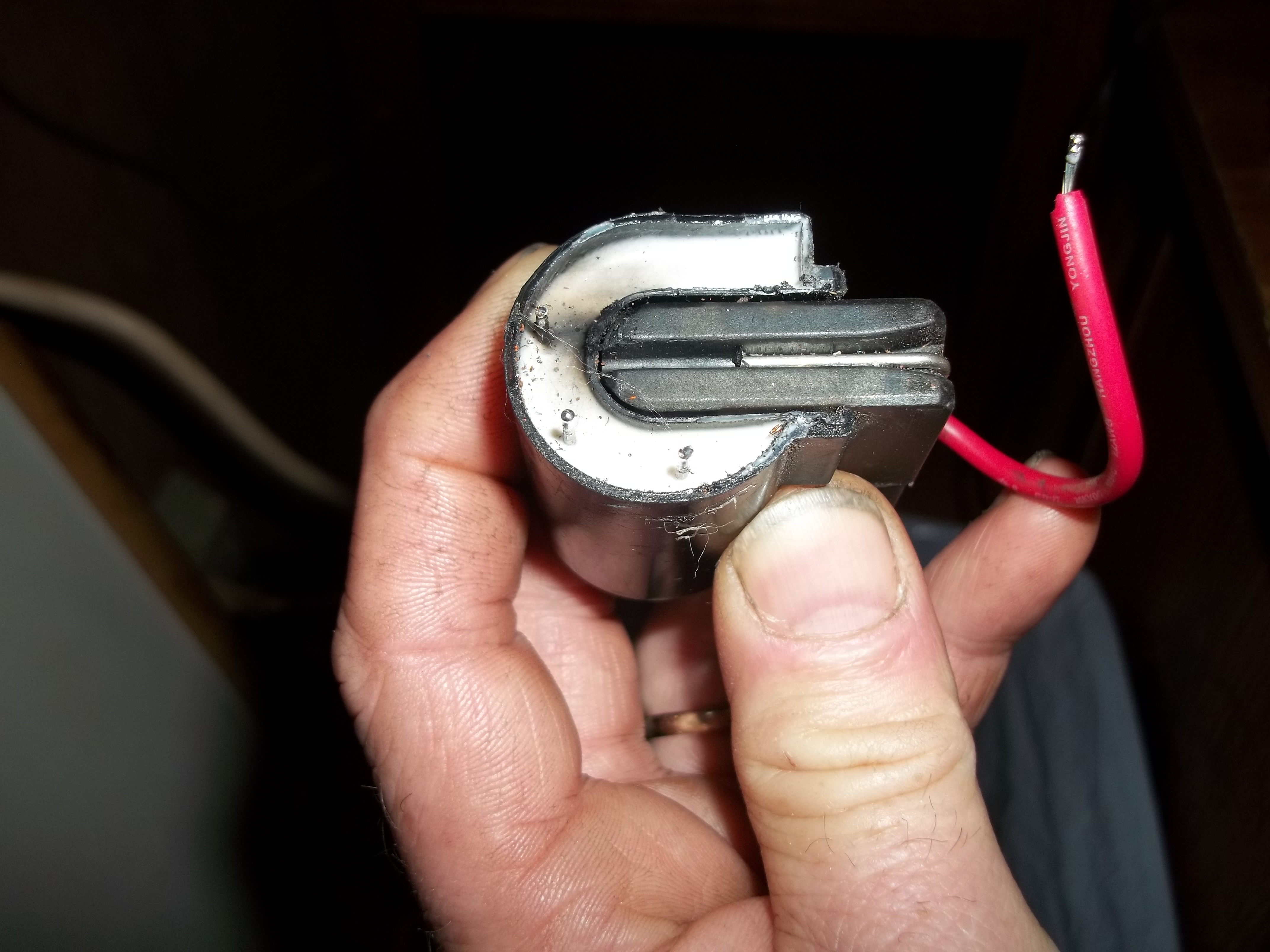

i sure hope some one can help,trying to find parts
fly back transformer the part # FT-N503 i cant find nothing,
here is the model #EP22899 IGBT for the plasma cutter,i hope you can help...
i will also attatch a pic of the board, THE BOARD # GI-PCB-Z11-A3 ..to the right of that is more #'s they are C158649
there is also a resistor blowed. and i cant seem to find any info on it
the plasma cutter says on the front FDS CUT-50 this is a 220volt unit

ya no repply,note of caution, i think it was my fault it blew,,lol, i found a huge ammount of metal grinding dust,and some die grinder chipps inside,leading to a short,:confused:
so i found out from a youtube vid ,some company's recomend to remove the top and blow them out often ,
for most cut 50 and many more,except mine,,this place in china has the replacement boards,just alot of serching,,AliExpress.com - Online Shopping for Popular Electronics, Fashion, Home & Garden, Toys & Sports, Automobiles and More. just search PLASMA
i also just ordered another cut 50 its a little diffrent then the one i caint seem to find parts for or any info , mine says FDS on the side, so i should be able to get parts for the new one,at the link above,

no seller response, figures,
mine said FDS on the side ,from what i have found, they use several diff board designs in the machines,
mine seems to be a oddball,LOL
mine worked great, then metal dust got inside and well ,just say a bad smell of parts burning,
i bought a new one diff brand, but remember to take off the cover once and awhile
and blow it out, i got some parts on the way, not sure if they will work with this oddball,
