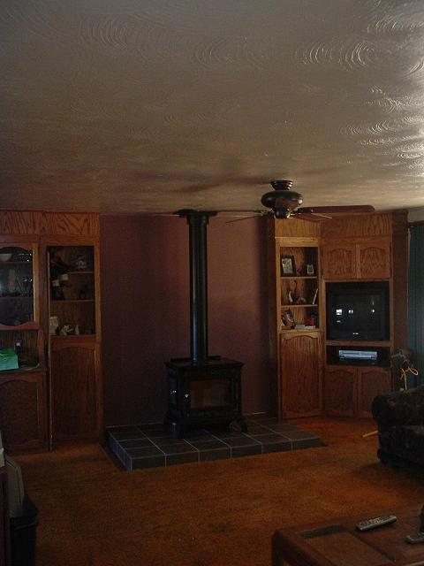

My chimney system is mounted to a freestanding soapstone stove in the living room. From the top of the stove I have a single adjustable length of Simpson double wall pipe (extended to 6') to the ceiling support box. (130$ for this connector pipe) Then once in the attic I use two 4' sections of class A Stainless steel solid packed Simpson pipe which extend just about 4' above the roof penetration providing both the minimum total chimney length as well as the proper roof clearances for best draft. At 5' of height I would have needed a roof brace so needed to stay below 5'. This 14' system has no bends and I can brush any creosote right into the stove with no dissassembly. The single joint in the attic is twist-locked as well as screwed for safety. It drafts well and predictably.
The total install was right about 1200$ which included labor, roof flashing, ceiling support box, chimney cap, and whatever other widgets he needed. It was spendy but this is a safety thing for me and I used the best Simpson product they make. The SImpson site has lots of good pictures to help you price out and even build a system.
There is cheaper class A pipe out there that is rated for the same temps. I don't think that they even make triple wall anymore except for specific ZC fireplaces.
You only use one ceiling support box which supports all the class A pipe above the stove. Then each floor that the chimney passes through will utilize a fireblock type thing but not a support system.
