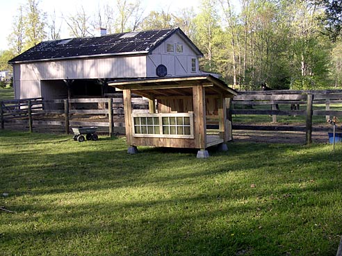

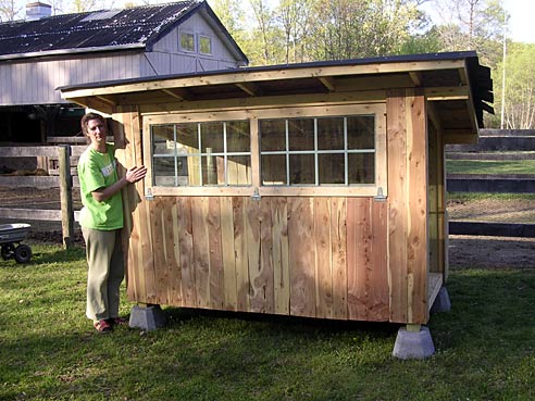

Almost there. Needs doors, roosting bars and litter box.
But the chicks are not ready for the big coop yet.

Great looking coop you have there. Cute little cheeekens too.
/ Chicken coop in progress #3
Nice looking coop; Guess I'm going to have to build one. Some friends brought a hen to us that was sitting on 5 eggs. They should hatch in about 10 days so I've got to get busy.

Since nobody asked :D - I got those windows at Habitat For Humanity at Manassas - dollar a piece - and I just took off the vinyl and framed them with 2x4s.
It was on hold for few weeks, i was waiting for a local guy to mill me more cedar boards, the idea is that cedar will keep the bugs at bay at least little bit - and the wood was free too. I like to work with cedar.

I just caught this thread, but I noticed the windows. I built one last year and used the window panel from an old garage door someone gave me. I did hinge mine at the top so I could prop it open and rain wouldn't blow in. Nice looking coop, I like the cedar siding.
#11
Thank you, if I used plywood I would be done sooner, but the cedar will hopefully help with bugs and such too, nice wood to work with.
I went back and forth on the window, this one can open all the way down to provide maximum air if necessary - for hot summers. There will be 1x1" cage behind the window to keep them ladies safe.

1x1....??? Wouldn't that still allow a pretty decent sized snake? I think I would 1/2x 1/2 would be better....but I have no clue, gut feeling is all.
