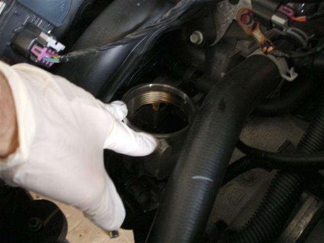

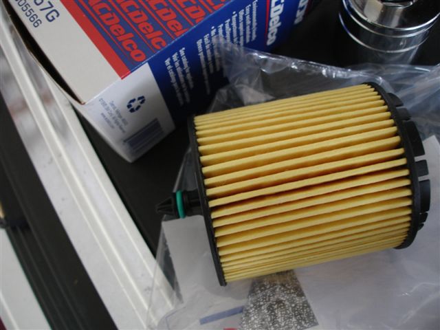

I changed the oil on my 2007 Chevy Malibu this weekend. WOW! Have they made it easy! The oil filter canister is located on the top of the engine! 1 1/4 inch socket and I pulled the filter out and no oil leaking anywhere. I took some pics to show how easy it is. Nice job GM! I should mention the 2.2L 4-cyl Ecotec engine with a 4 speed automatic gets 34-35 MPG on the freeway (flat Midwest terrain) at 70 mph.
Bob
PS Anyone else wear gloves when changing the oil? Does that make me a wimp?

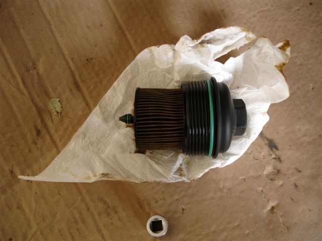

Good comment on the particles. Take a look at the little "pointer" on the bottom of the filter. It has a seal that I would guess "seals" the filter outlet and prevents particles from migrating out of the filter canister. What do you think?

I see the seal you are talking about, I am sure that is where the oil gets pumped into the center of the filter and then on the outside of the filter it gets pumped back into the engine. That kind of solves the problem of particles falling back into the engine.
Now if it were me, whenever I change the filter I would make sure to clean the filter housing out really well. I can see some stuff getting trapped or left behind in that housing or falling in while changing filters. Cleaning out the housing is just one extra step but worth having peace of mind.

Plus, the quality of the materials and workmanship is right there for you to see...not hidden inside a can. It's also easier to examine after removal--no can to cut open.
