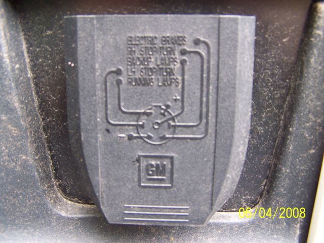

The wire under the hood is probably the B+ hot lead that feeds the B+ terminal at the trailer plug. It does not come hooked up from the factory. It can be hooked to a fused point in your under hood fuse box (I actually replaced my fuse with a circuit breaker). The owners manual should tell you where to hook it up. The 05 I had came with a wiring harness in the glove box for hooking up a brake controller. The controller wired to it and you plugged the harness into the fuse box on the drivers side of the dash. At that point all wiring to the plug at the back of the truck should be working. It is not necessary to have the 12V + wire hooked unless you need 12V to charge a trailer battery. I have a winch and electric/ hydraulic unit on my trailer with their own battery. The 12V terminal in the plug keeps it charged while driving. Wiring should be as it shows on your 7 pin cover. If all wiring is correct there may be a problem with the controller you bought.
