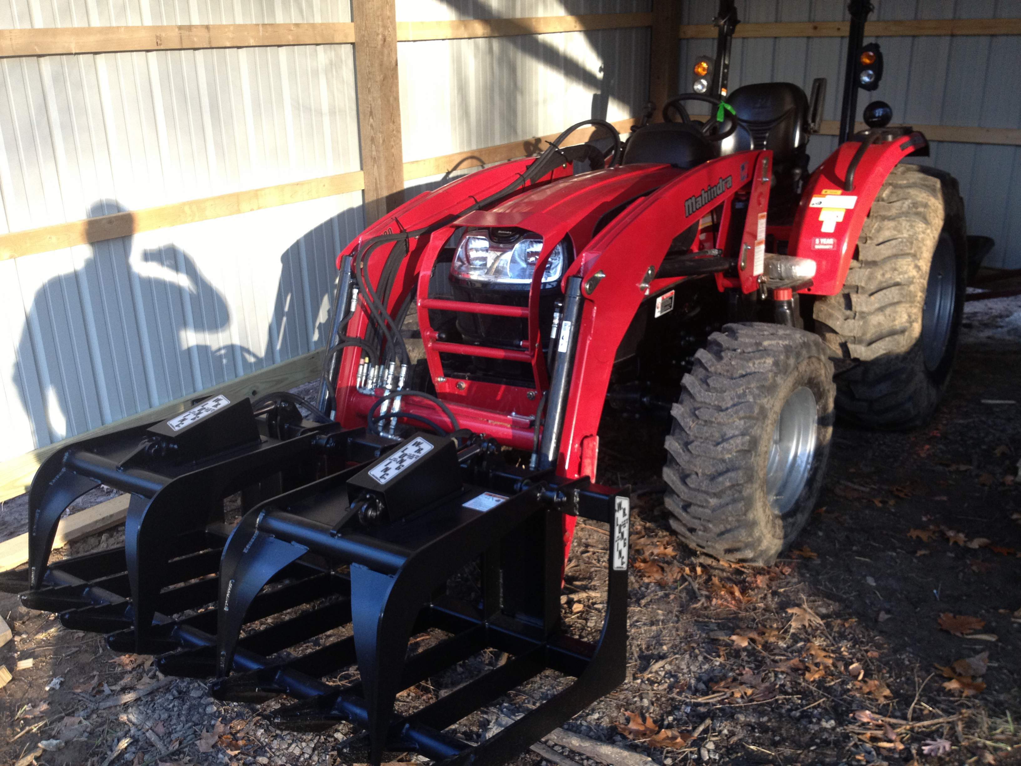

Read over the owners manual - still very unclear - where should I be checking the level of, and then if needed, adding to, the hydro fluid for my tractor?
It's an HST - does it use the same reservoir for both the HST as well as the FEL or are there separate ones?
   / Checking and adding fluid for a 4035 HST #2
It is a 'common sump' tractor [ like most ]... the trans and hyd system share the same large resevoir. Right by the PTO shield.... :)
   / Checking and adding fluid for a 4035 HST #3
If you have your owners manual for the 4035 handy, there is a full-color foldout page almost all the way to the back that details exactly where to check and fill the hydro fluid. As JerryK said it is right by the PTO shield. Should have a yellow label on it. (At least my new one does.)
