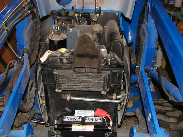

As is my standard, Saturday morning practice, I checked the fluids in all the vehicles and the tractors. Cleaned the grass clippings off the tractor deck and outside grill. Thought I should open the hood and check the radiator as well, which was good since it too was covered. As I cleaned around the battery, I noticed a bunch of 'cottage cheese' around the positive terminal. This 'cottage cheese' had eaten through the wire I had connected for the four lights at the back of the tractor. I ended up pulling the positive cable, cleaning it, putting another lug on the wire and reattaching. I also pulled the battery hold down clamp which had several spots of 'cheese'. Cleaned and sanded it am in the process of priming and painting it now. So, Boomer owners, check your batteries!

Is that the rubber hose laying on top of the screen? Mine just lays there. Should it be attached to something? I don't remember it ever being connected to anything. Never gave it much thought. Kent

Kent, on the 25D the tube that lays on top of the radiator runs back to the air cleaner. See attached picture.

Thanks MikePa, My 21D has the same thing. I can pickup the front of that hose, and take the screen out. It just lays on top of the radiator. Thanks I feel better. Kent
