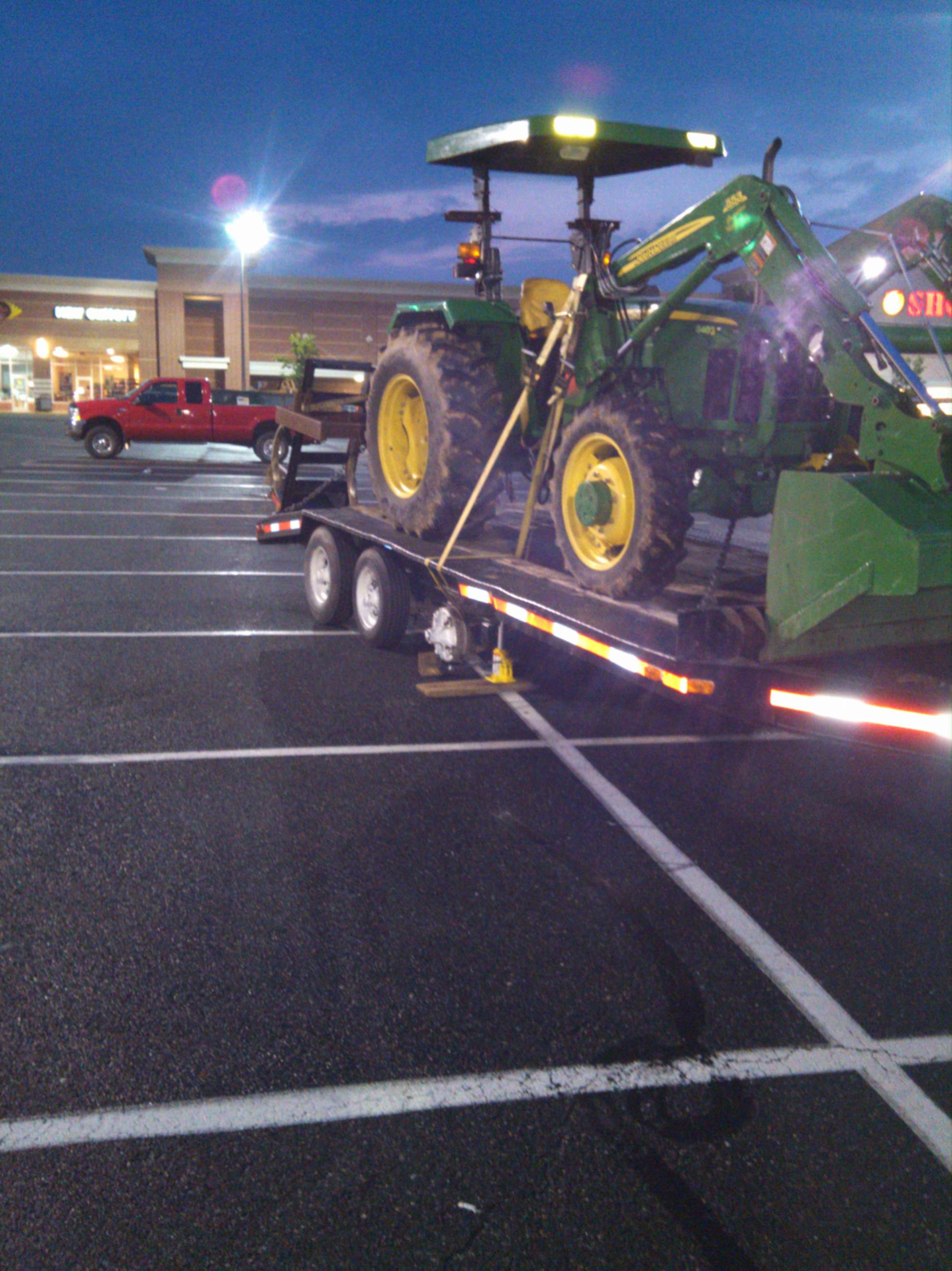

BigBaller,
Glad to hear that you came out alright. I had the same thing happen to me. It was on a trailer however. I do not have anyone to blame but myself. This trailer has the demountable rims. I think I torqued them well enough. But, I did not seat them correctly. All 5 studs were broke off and the tire and rim went flying off the side of the road. I never did recover them. I reckon the state picked them up, or they are still laying off in the grass somewhere along side the road. I have looked. Heck, I had just bought the tire earlier that morning. It wasn't even on the trailer a good 6 hours! That lesson cost me $200 ($115 for the tire and another $85 to get the studs removed from the hub). Now I check before and after every trip and every so often along the way. Lost Wheel.jpg
