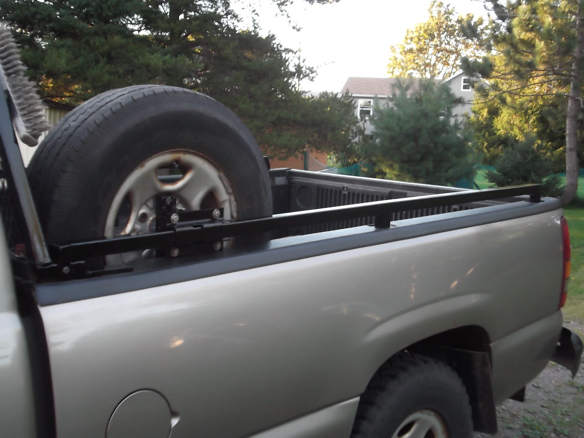

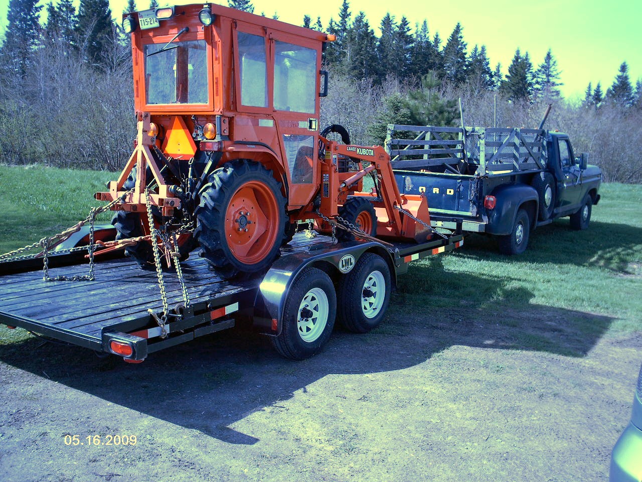

For all of the above reasons, plus (on the salty winter roads around here) serious corrosion of the spare wheel under there, I mounted my spare up in plain sight (but easy access) on the box rail behind the driver. After 23 years with the spare mounted on the RHS step on an F-100 fenderside, I just don't like those under frame mounts.

Herringchoker, that picture of your F100 is just awesome. :)
