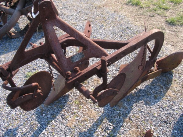

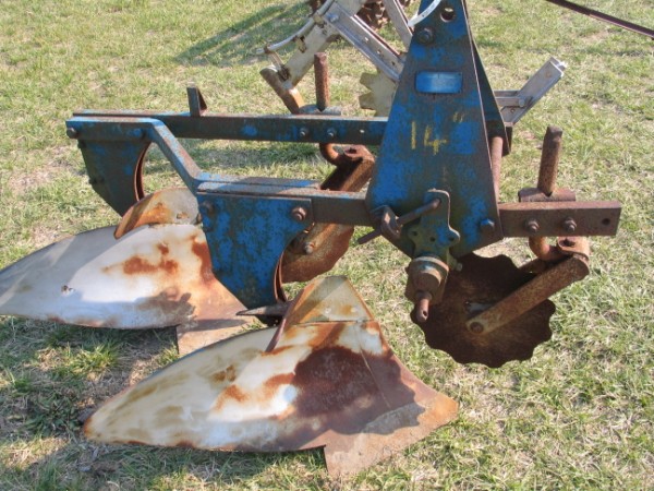

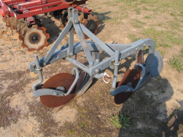

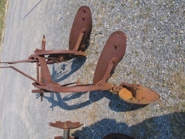

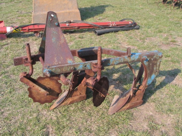

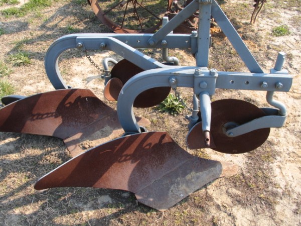

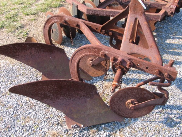

Hello All,
I am in the market for a 2 bottom plow to go with my soon to be purchased tractor, so I stopped by the lot of the local equipment auction (coming up on Saturday). I found a Ferguson (14-AO-28), a Ford and a Dearborn among others with broken or obviously badly worn parts.
Can someone tell me exactly what I am looking at? Have I found something worth trying to buy?
I will apologize in advance for asking these questions. I imagine these questions about the history of plows have been answered here before. But I thought I would ask directly since I was only gleaning bits and pieces from researching old threads. Links to old threads on the topic would also be appreciated.
Thanks,
Glen

Given a choice, take the Ford 101 (Middle of the three) Much easier to get new wear parts and a better plow to begin with. 101 was made by either Pittsburg Plow & Iron in the beginning, or later models (the blue ones) were built for Ford by White/Oliver. They're amongst the best 3-point plows ever built.
Around where I live, I'd expect #1 and #3 to sell for $175 to $250 and #2 from a low of $250 to as much as $400. I've plowed a many an acre with a Ford 101 3X16". They pull easy (if adjusted correctly), hold up well, and parts are easy to come by.

Thanks FWJ. Exactly what I was looking for. From what I had read on here, I suspected I was on the right track, but wasn't sure.
Glen

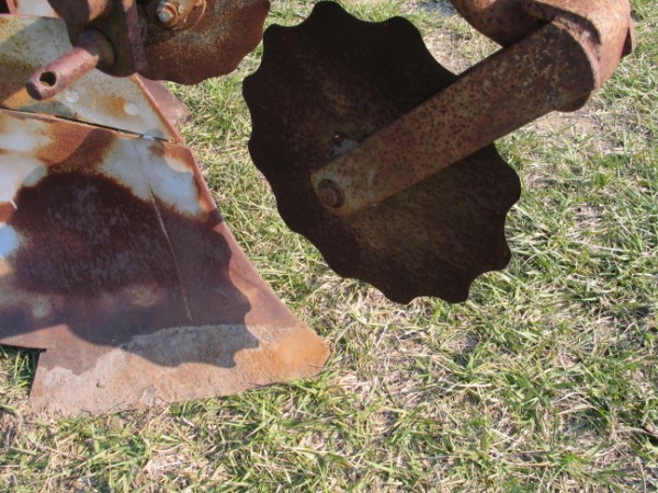

where do you get parts for a ford 101. I have a ford 101 3 botton 12 inch and I have not been able to find replacement parts for a 12 inch.
   / check out these plows at the local auction #10
12" plow parts of just about any brand are getting scarce. Not sure you'll find them other than just by chance. You might try fitting 14" shares and shins. I'm not sure, but they MIGHT fit.
