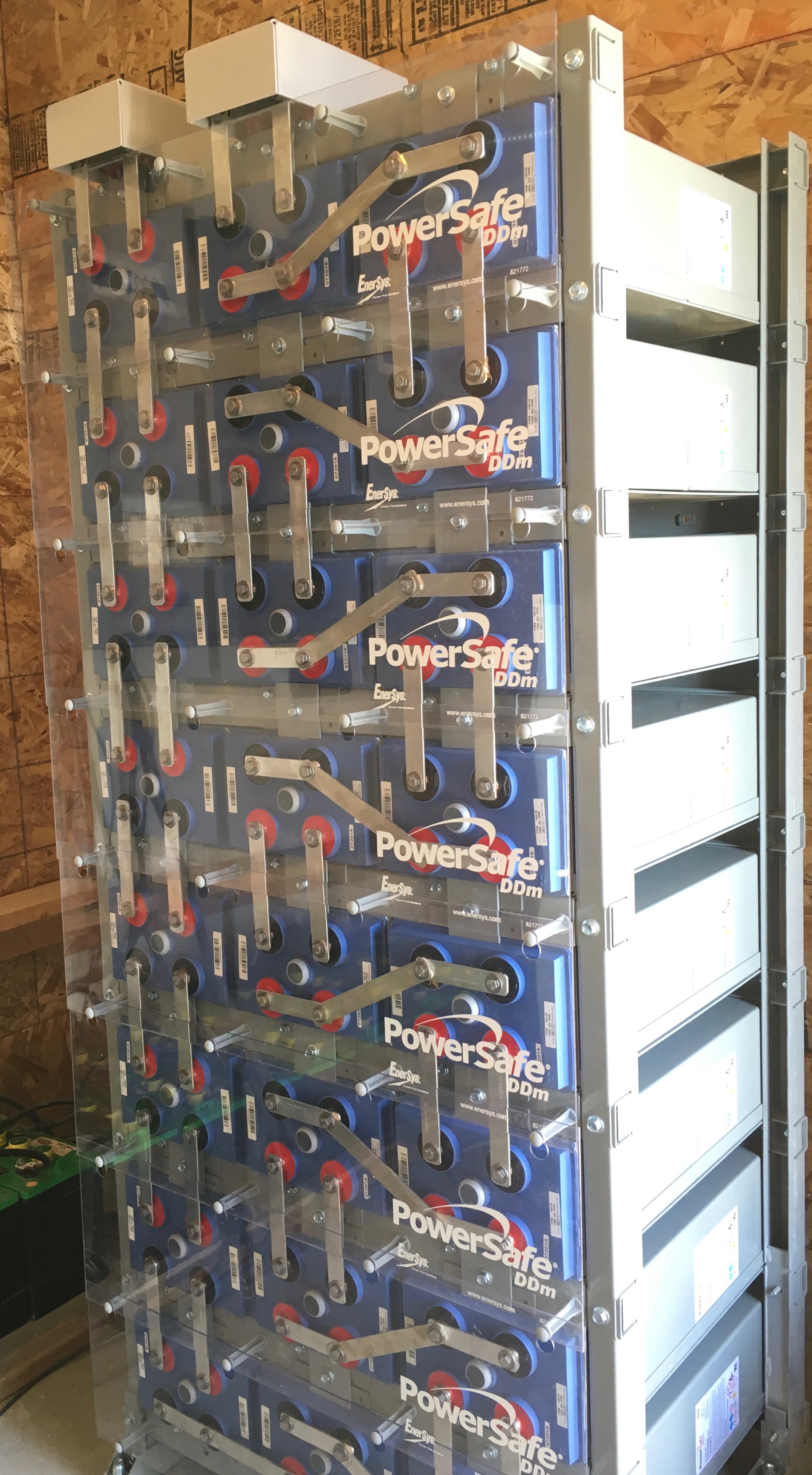

We were finally ready with the property to install the new battery for the off-grid power system. The plan is to finish out the room in drywall as well as mud/tape, prime and paint. I'll remove the temporary battery bank this weekend, and get it all cleaned out and ready to finish.
It's a 1600Ah, 48v battery bank made up of 24 2v cells. It is 5,500 pounds as it sits on the concrete floor. Was a monster to assemble, but I am super stoked.

Going to be tough getting that under the hood of the Deere ! Are they gel mat ?
Yes it would! And yes, they are glass matt batteries. One had a small leak (or had leaked at one point) when they arrived, they said it isn't an issue for the short term and are going to ship a new one. No fun to replace one, each cell weighs 222 pounds.

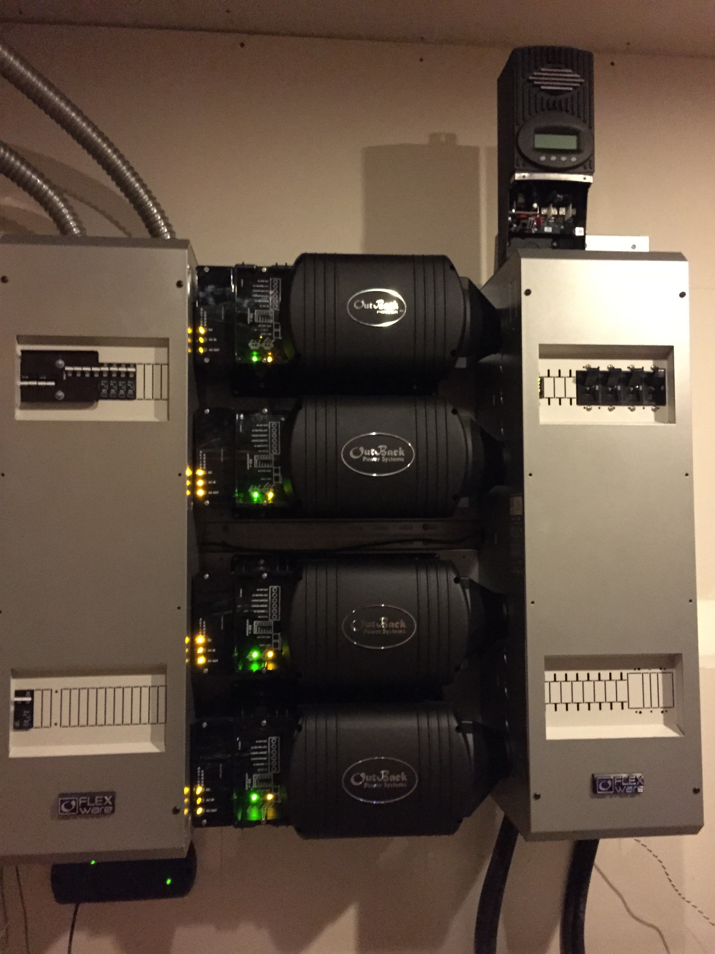

This is the first 4 VFX inverters installed and operational, the next 4 go to the right of it (this is in the same room as the battery).
I ran ethernet cables from the electrical building to the house, so I have the control interface for the system close by. Makes everything a lot more convenient.
As you can see, I still have a few circuits to connect and we are just finishing the mudding/taping, next week we will be priming and painting.

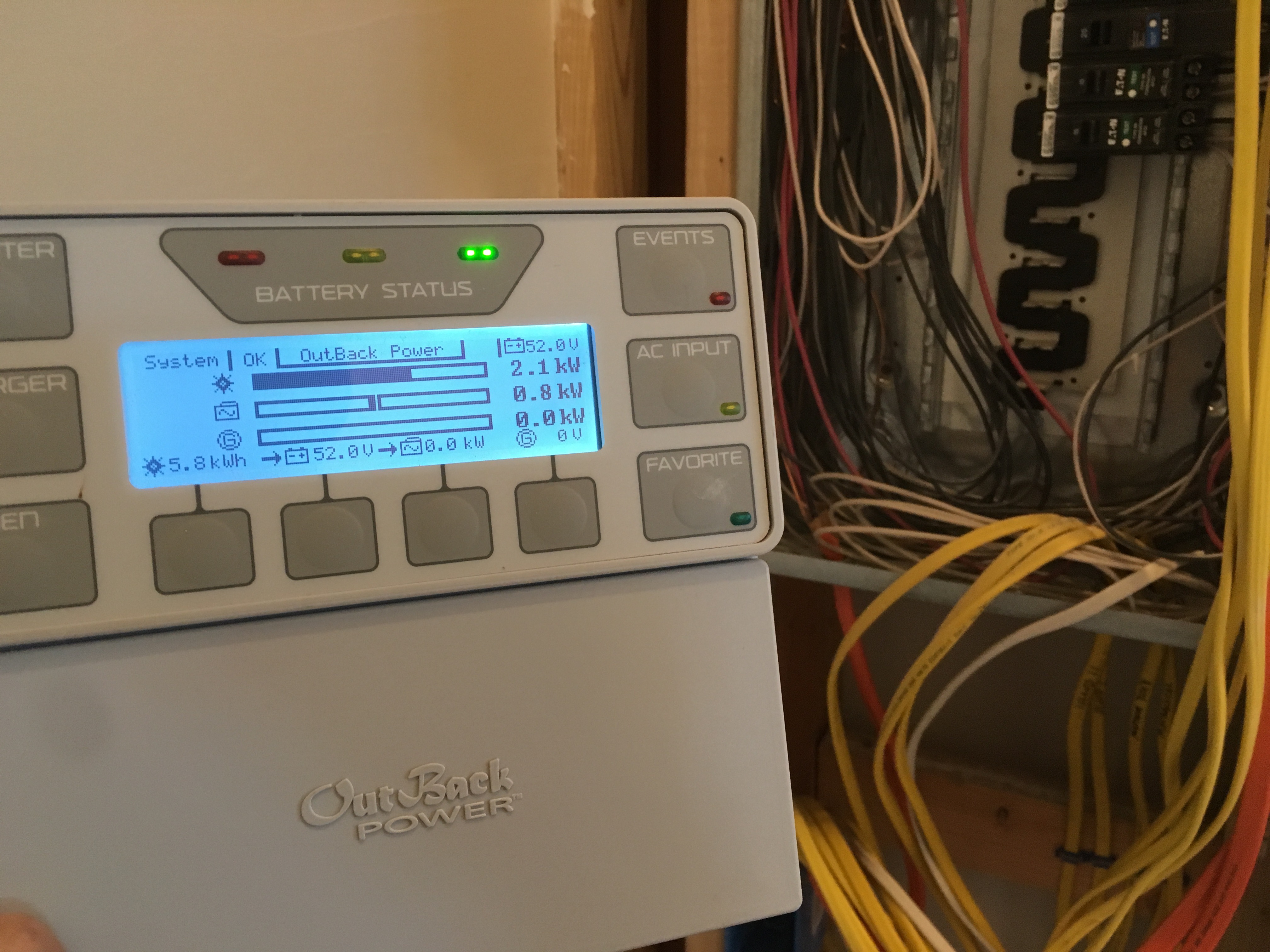

This is a screenshot of Outback's OpticsRE system. Live data is sent up to their cloud system for monitoring. This is with only the first 12 panels connected.
I am really impressed with the AGM technology, the battery seems much more stable and I have less voltage fluctuations with this larger battery. The generator hasn't run once since I connected the new battery.
Most people would be very surprised to find that their actual power consumption isn't that high, and that a small to medium sized system would completely replace their power company.
I have it configured that anything over 4,000 watts for more than 60 seconds automatically fires the 30,000 watt diesel generator to take the load and charge the battery while running. It automatically idles and shuts off when the load drops back down to 3,000 watts.
