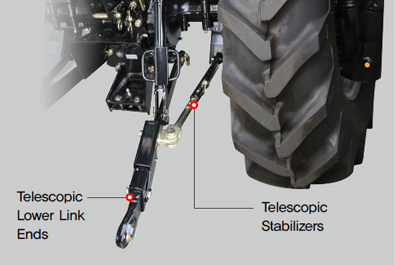

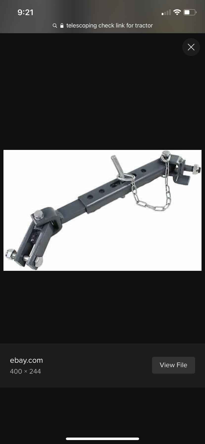

Is there an after market product to replace the cheap check chains for dk4510? I’d like to have the telescoping bars that are found on the nx series. If not will the nx series work for the dk series? What I’m looking for is in the pic. Only the pic is for kubota.
   / Check chains #2
My 2010 DK35SE has the good ones with flimsy chains. Lowes sells a small strong welded link chain. It's like 800#'s test and I've used it to hang porch swings in spite of the size.
   / Check chains #3
Ask your dealer if he can get the "DKA145 Telescoping link kit DK".
I added that to mine at tractor purchase for $320, includes the telescoping lower links and stabilizers.
   / Check chains

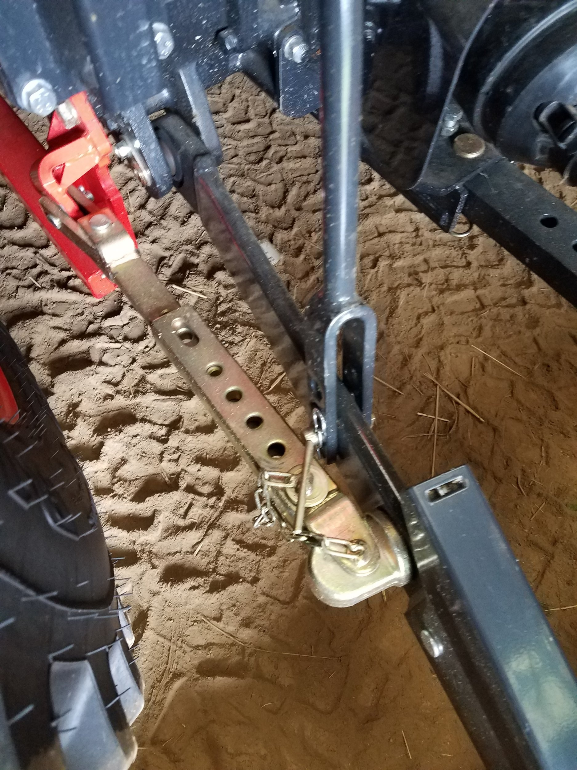

Can ya send a pic of just the bar on your tractor. I tried zooming but it’s blurry on this pic
   / Check chains #5
   / Check chains
Appreciate ya! That’s exactly what I want. Damn a turnbuckle!
   / Check chains #7
I too ordered the telescoping lower arms. The kit comes with the better check Chain assembly.
