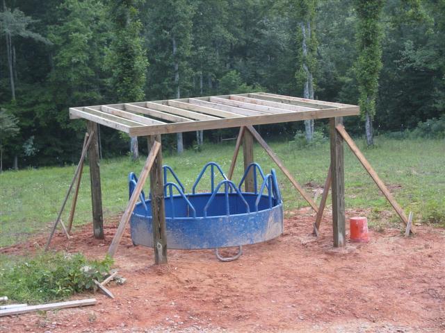

Blue Tarp ???????????
/forums/images/graemlins/grin.gif /forums/images/graemlins/grin.gif /forums/images/graemlins/grin.gif /forums/images/graemlins/grin.gif
Just kidding, I have a shed like that for my round bale of hay and it went together easy and is plenty strong....
Attached is a picture before I put the tin roof on.....

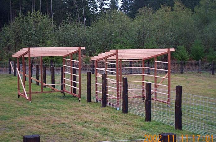

Hey Cracker, you been spyn' around my place? Or is it just a great minds thing? /forums/images/graemlins/grin.gif
These are 10'x10' shelters for the ponies, but no reason they couldn't be streched a little deeper for a tractor. The front has over 8' of clearance.
