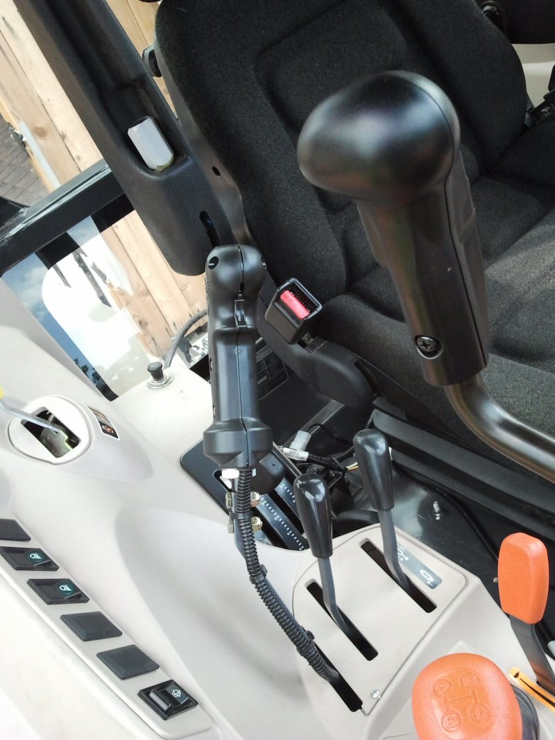

Here are some pictures of a customer's M7040 that needed 6 sets of rear remotes. No problem to add just one if that's what you want to do. He has full feathering capability with all of his remotes. :cool:

So you added a splitter/ hydraulic multiplier with solenoid operated valves? Does the hydraulic multiplier work fine? I have seen some that make two from one advertised for about 500.00 on ebay (Iowa farm equip I think)
