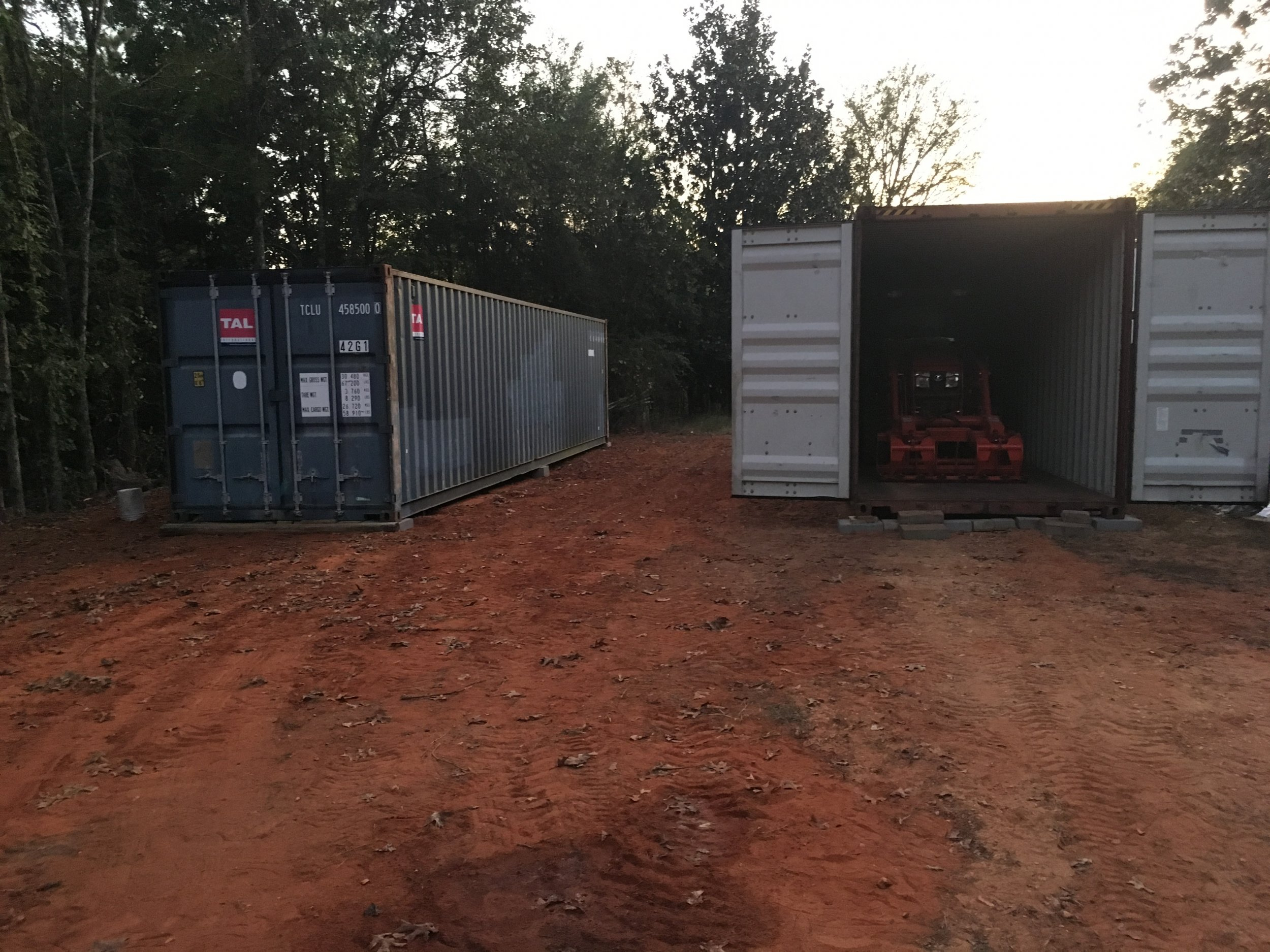

This is my solution at our remote property. No rain, no sun, and most importantly no mice. Cheap and as secure as any shed.
Those are intriguing i have struggled to find clear info on them though.
how much does something like that cost? Where do u buy them from?

I guess it depends on where you’re at. Due to the trade imbalance with China and Seattle being a major port city, they are about $1,000 delivered for the 40’. You can move them around with pipes and 4x4’s like the Egyptians did...
I’d have to research the sizes, that’s crazy about moving them, crazy awesome.
if i could get them for $1k delivered I’d probably start scoping out the perfect location for it right now!
that really seems like a steal
