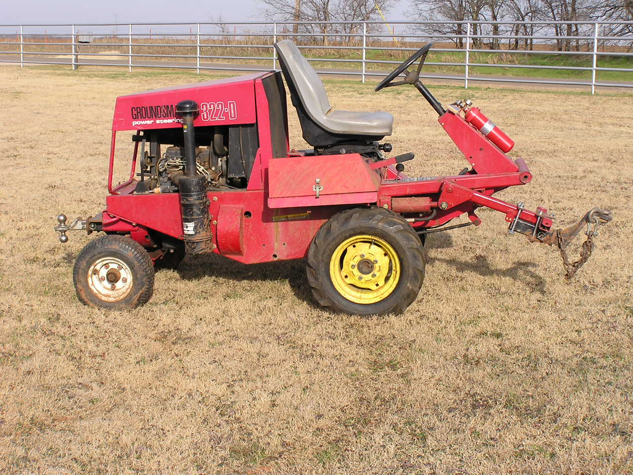

   / Cheap tire spacers #5

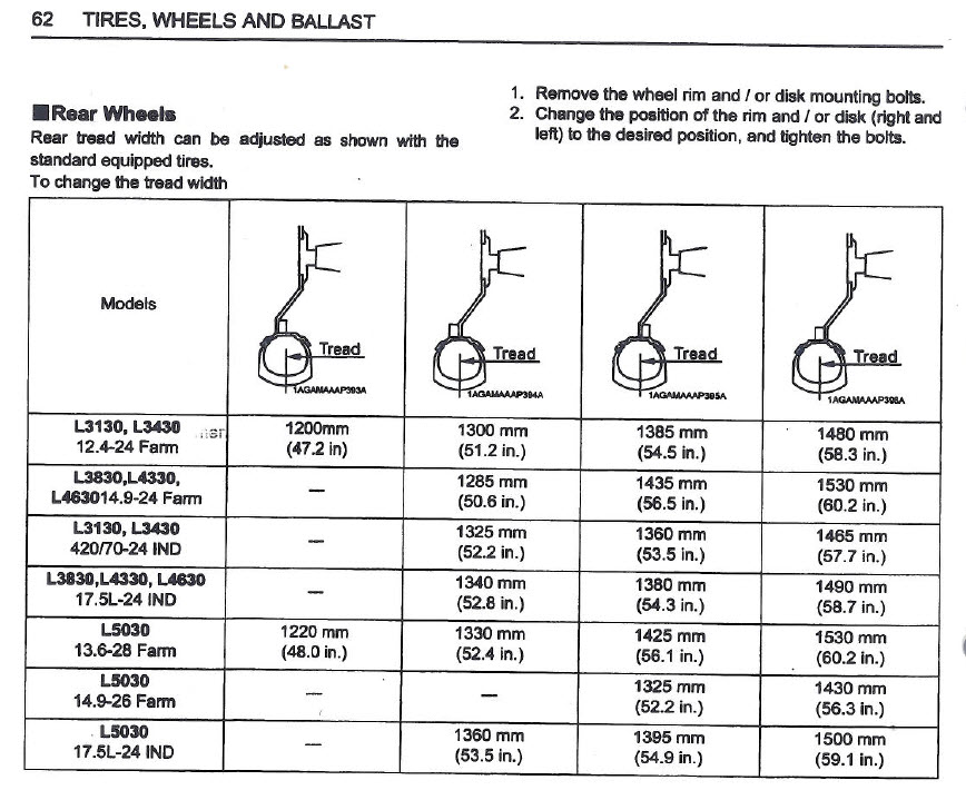

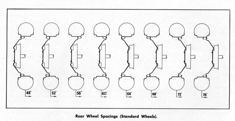

If I switch the tires over, would it give me more clearance?
It depends on how the wheels are made. You operators manual should have a chart like this, if it is possible.

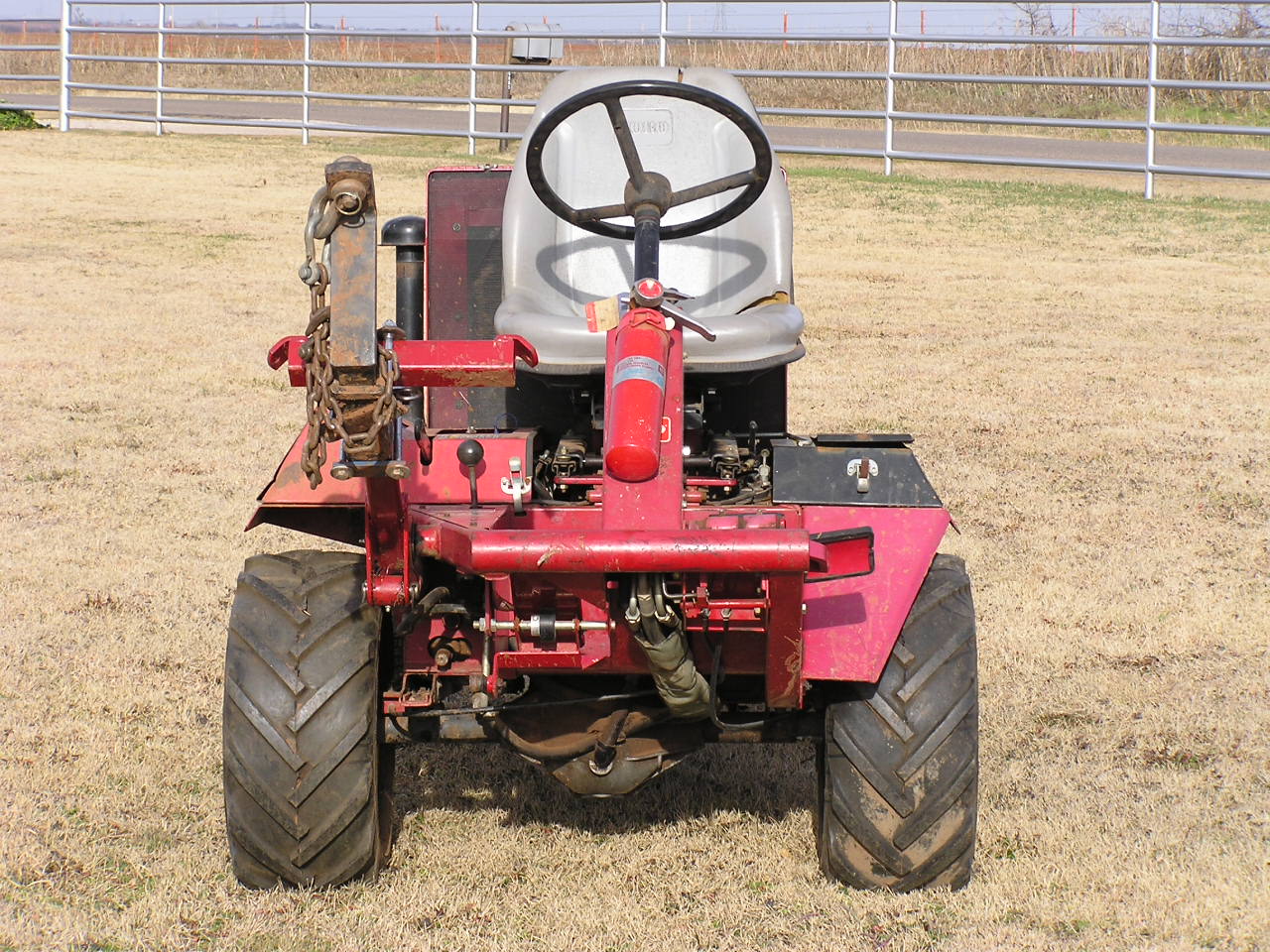

I swapped mine side to side (keeps the direction of rotation correct), after I rolled it, to get more width.
   / Cheap tire spacers #6
Not sure if you have rims capable of being swapped from side to side. My current and last tractor were not. Rims are one piece and not bolted like Xfaxmans pic.

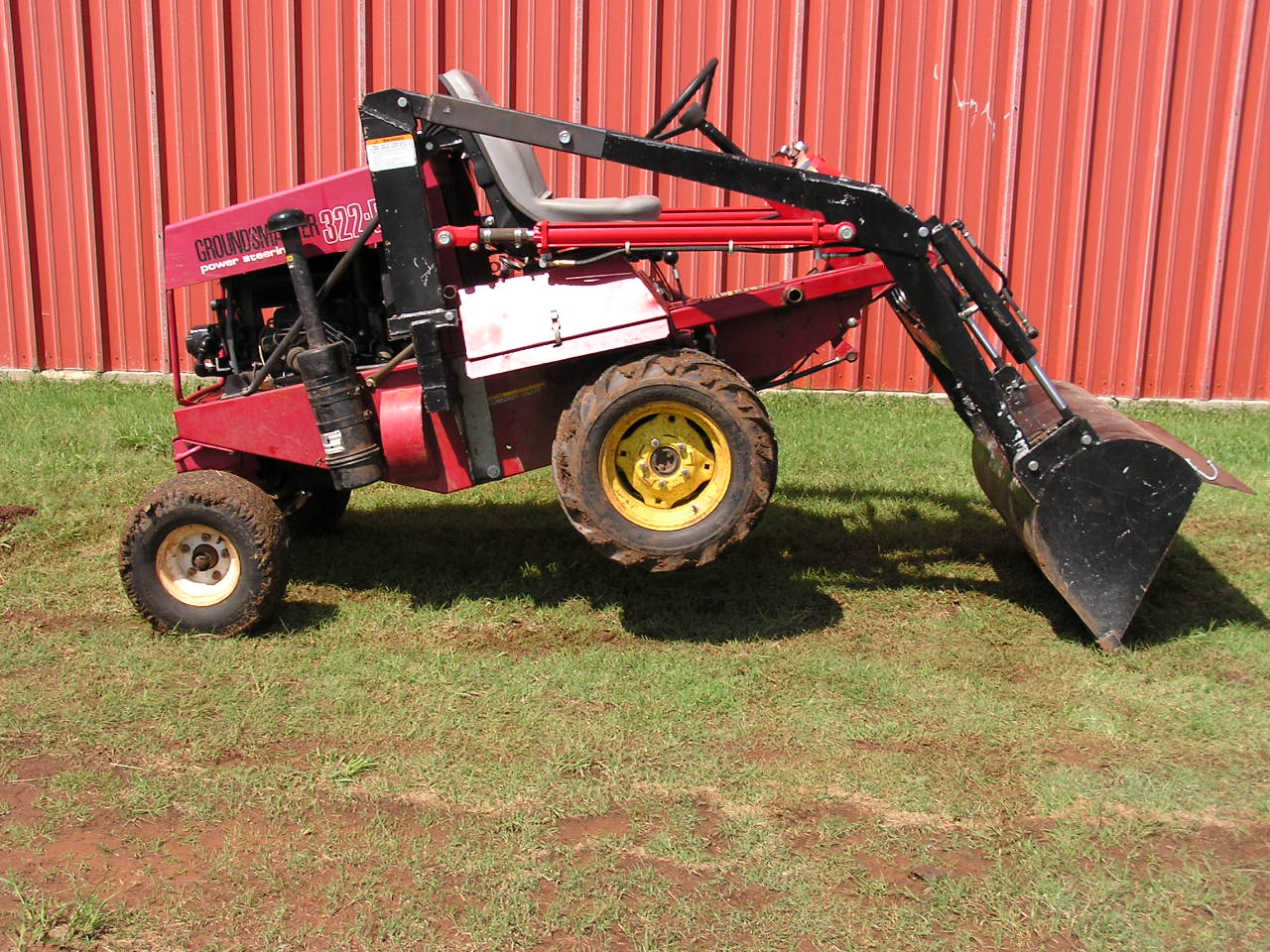

   / Cheap tire spacers #8

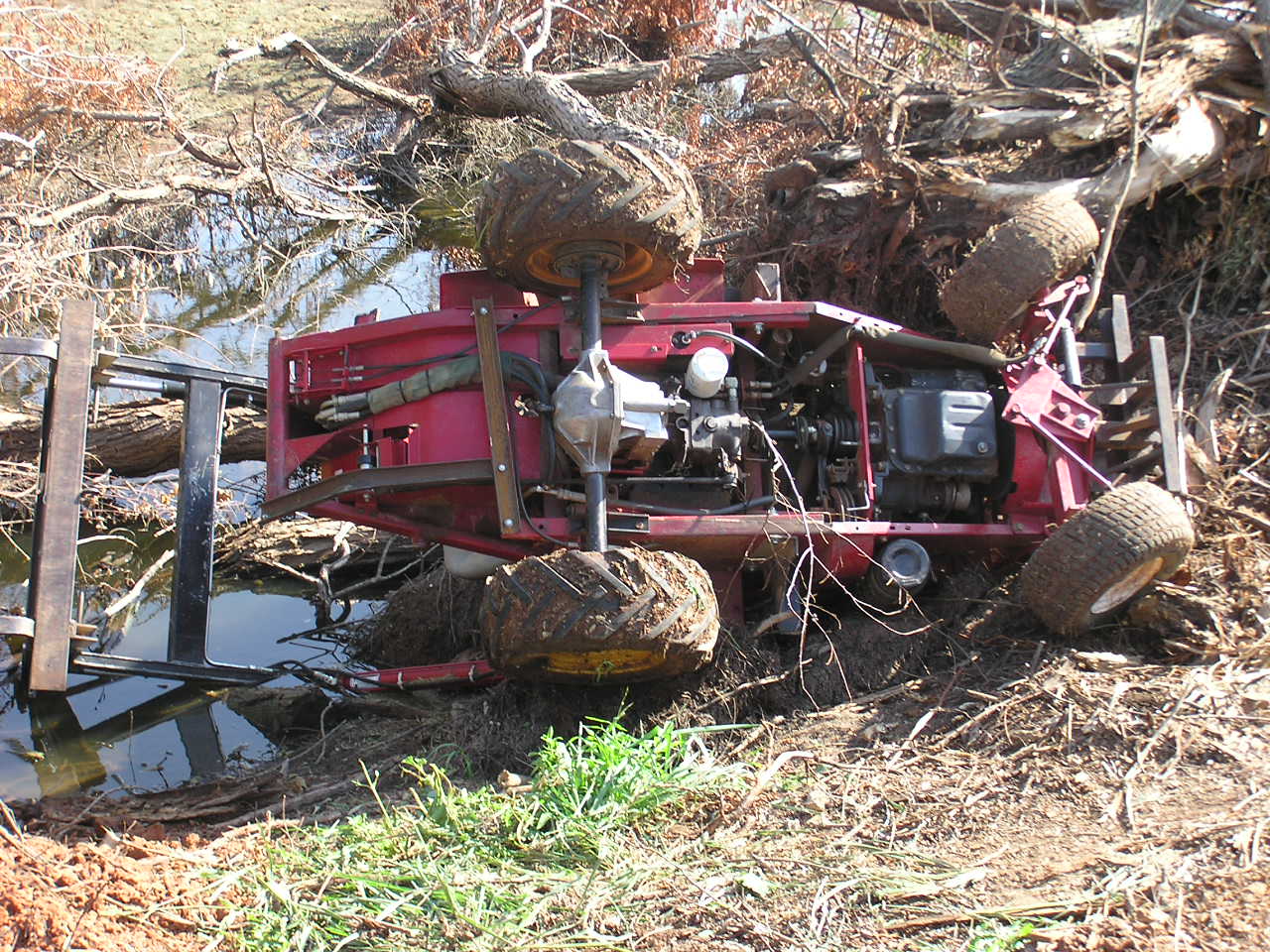

Seeing the underside of that Toro confirmed my suspicion of how they were built. Hope you were not injured in the tipover.
On my 4300 I gained about an inch and a half turning the rims around. Enough to be able to use the chains on my R4's. Yours may be different.
But my manual gave the differences gained.
   / Cheap tire spacers #9

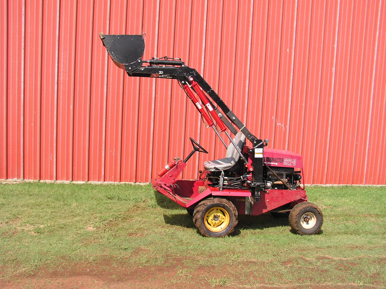

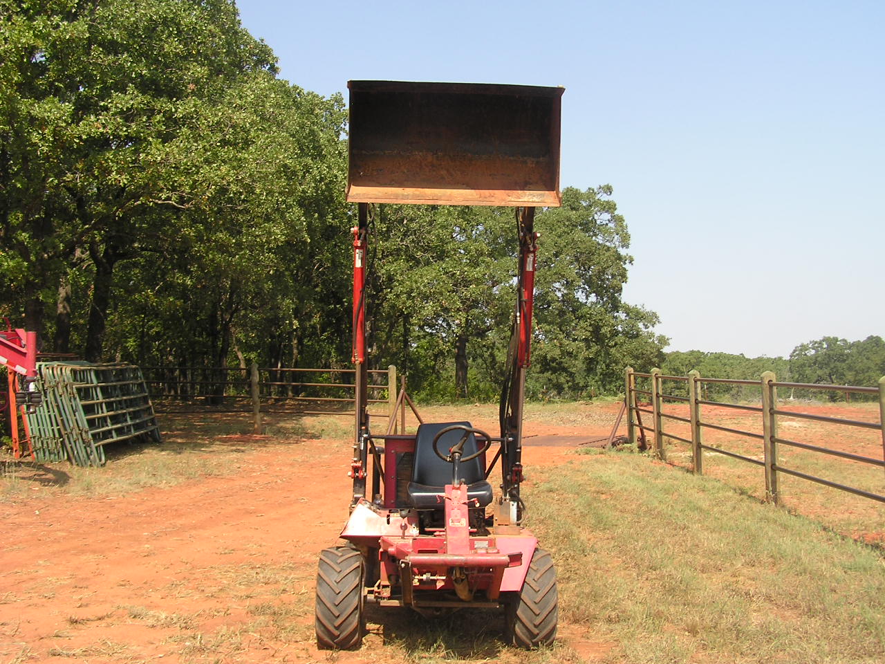

The rims that I swapped on the TORO are one piece and the stud hole is beveled on both sides.
It is the offset of the rim that makes the difference.
You can take one wheel off, turn it around, if the holes are beveled put it on backwards with three lug nuts. check the fender clearance, if more, take it off and put it on the other side.
