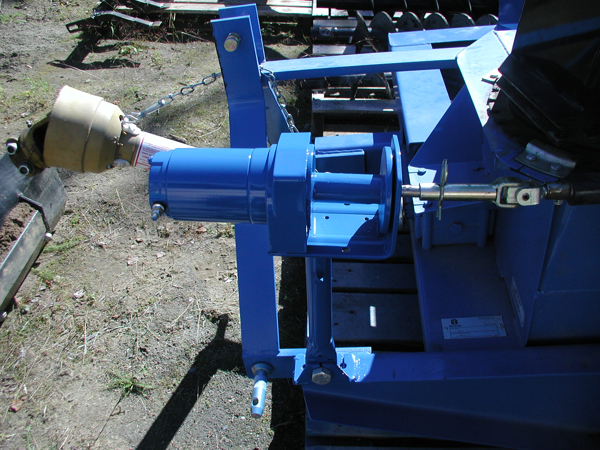

I got a 49.95 atv wench at costco and with welder and some thought put a very nice snow blower motorized shoot togrther. works great i operate from my drivers seat .no turning that stupid hand crank (HELLO) JUST A LITTEL THOUGHT WILL GET YOU A LONG WAY. And keep bank full of money.

Good idea! That should make life more pleasant while blowing snow.

Nice idea and great fabrication and paint.

an electric window motor would likely work also.... few bucks at the pick-n-pull

Actually just about any electric motor will pull you out of the ditch, with the proper gearing. You just got to have plenty of time and some steep gearing. I have a 1/2 hp motor that will move massive amounts of weight, to a point I worry about the gearbox case splitting. However, it has a triple reduction and takes over 8 hours for the output shaft to make a turn. Slow, but steady as she goes. With the freezing temperatures, I would hope for a more powerful backup, that is a little faster, but what the heck, we don't have those problems down here very often. (if ever)

Key word in the title is cheap! I was making the observation that the cheap Chinese Costco electric winch will probably last forever when used as chute turner, but use it as a winch, and it'll burn up quickly, I know, I see lots of them at auctions, and they all have given up the blue smoke of electrical defeat!:D :D
