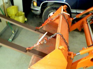

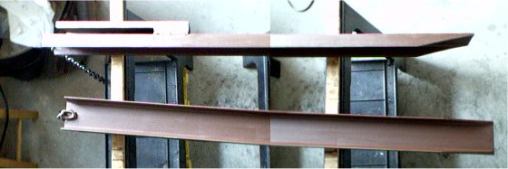

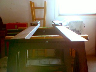

Read the story in build it yourself by clicking <A target="_blank" HREF=http://www.tractorbynet.com/cgi-bin/compact/showthreaded.pl?Cat=&Board=buildit&Number=130891&page=0&view=collapsed&sb=5&o=&vc=1#Post130891>this link</A>
I know this is a funky picture, but I combined 2 pictures to show the whole length in one post

   / Cheap Homemade Forks

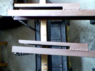

Another
Closer picture of the welds and cuts

   / Cheap Homemade Forks #4
How are they held in your bucket? I can see short lengths of chain attached to them. I don't understand... A picture of them on your tractor would help..... Thanks!

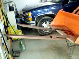

They slide right on...
Install seperately to any width
The load binders slide into the hand holds - no eyes or chain links on the top!

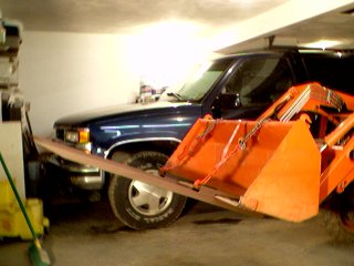

#9
Both installed and under tension - less than 2 minutes, light enough for a 6 year old to carry!
The final product!!
