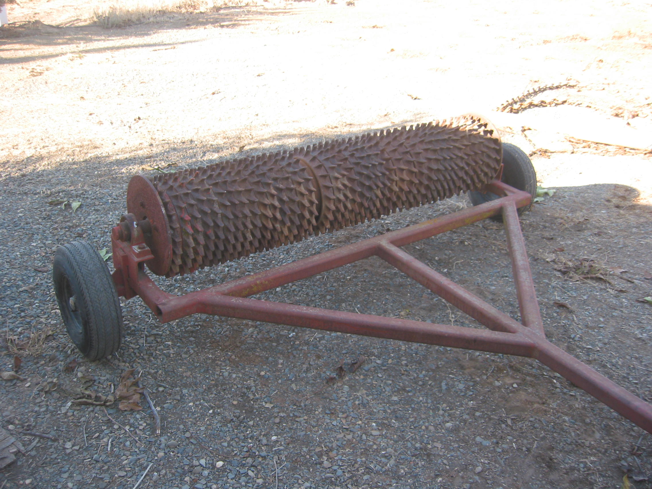

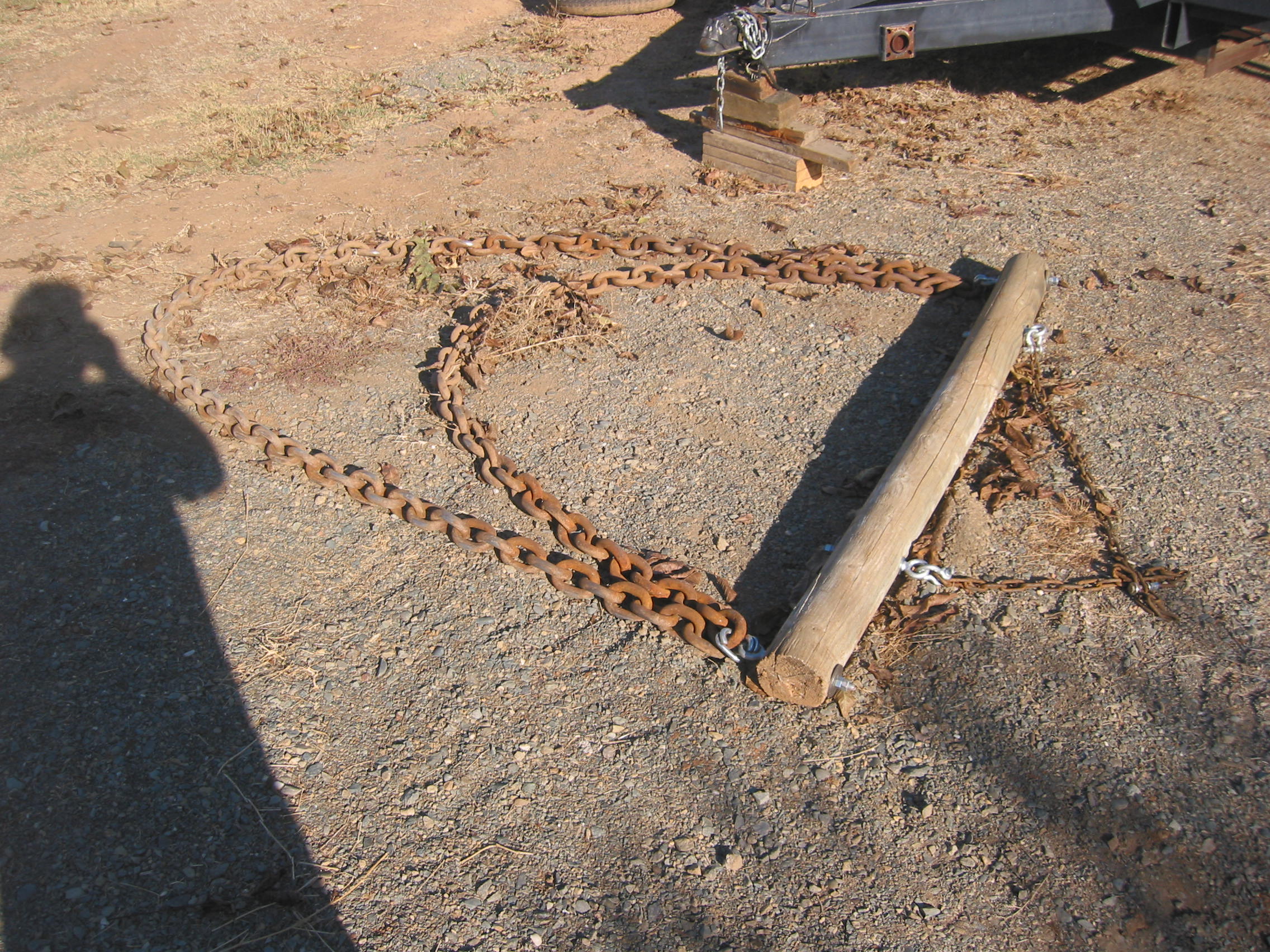

I use my ring roller but also have a log/chain drag that would work
